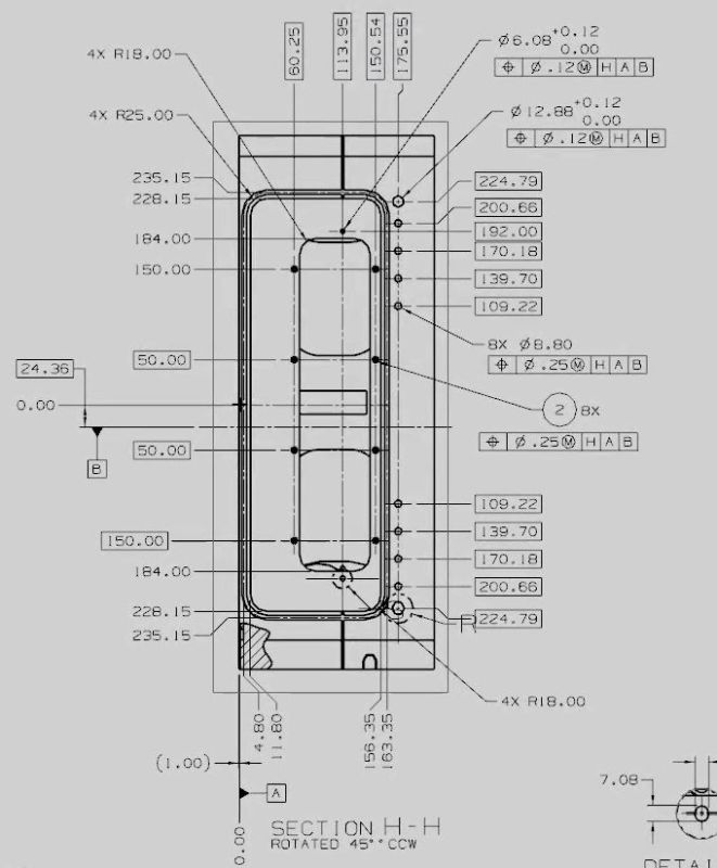

I've been working on drawings of complex parts that sometimes end up over 20 sheets. I'm always moving views to other sheets and sometimes end up with a projected view or a section view that I'd like to reference as if it came from a different existing view on another sheet. Is there any way to do this without putting in a fake section or view line?
I'm on NX11.

I may not be using the right terminology. My issue is, after moving the child view to another sheet, I'd like to associate it to a new parent view. For instance the section view below originally came from a top view on sheet 2, I'd like the callout to come from an existing top view on sheet 5.
RE: Associate Projected view to different existing view?
That I am aware, this cannot be done unless there's been a major overhaul with Edit View (for projected views) and/or Edit Section. Check the documentation to be sure.
