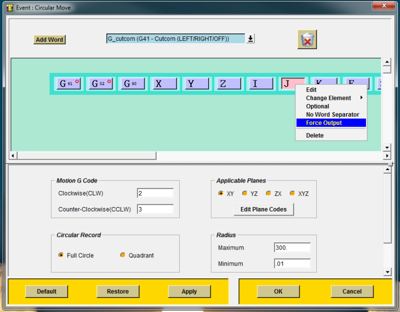

Using postbuilder in NX10 to process and on some lines there are g2 moves without i or j and I tried different settings in post builder but cannot figure out why this is happening. Most lines have i and j but about 4 g2 lines dont and it messes everything up. What can be causing this?
RE: no i j k in g2 move
Is the missing value the same as the previous value?
You can Force to output from the motion event

it might be, were do I find force output?
Right clicking will bring up this menu.
