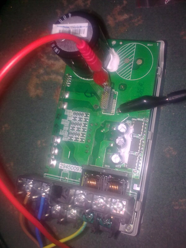

I just bought one to try to learn more and it looks like I've blown it before even starting!
I wanted to learn how to navigate the menus etc before actually linking it up to my three phase washing machine motor.
I connected it to my single phase supply and after setting the parameter to set it to factory defaults, I began to experiment with ramp up speed etc, and everything went fine.
Once I was confident that I knew how to control the basic manual operation, via the integral keypad, I hooked up the motor.
When I switched it on at the mains there wasn't even a puff of smoke, a crack or anything, but there was also absolutely no sign of life from the previously functioning drive.
The LED's are totally unlit, no sign of life at all, while there is still mains voltage measured at the input terminals.
Can it be dead already?
I'm just curious could I have killed it by experimenting with no load attached, as opposed to my three phase motor causing the damage once I connected it.
If the former is true then I just by another drive and try again, whereas if the motor is the culprit I would need to take a different course of action.
I do believe the motor is fine.
I trust the person I got it from who said it was fine. (9.2 ohms on each winding, and no path to ground).

Running it unloaded/unconnected would not piff it.
And unless you'd set it to some sort of auto-on it should not have "powered up black". Even if you shorted all the outputs if you powered it up it should light-up and be happy until you actually gave it a move command.
You've unwired the output again and it's still black?
I'd unwire the power input and rewire it just to be sure.
With what you've described I think it's infant mortality but let's see what others think.

All VFDs have a DC bus terminals near the input voltage. Check to see if you have the buss voltage their? Typical 3 phase 480vac bus voltage is like 600v.
Also, I would check the connections or how you put it together from your experimenting. If your display is not functioning that typically is a sign the 24vdc is not functioning on the drive, check the 24vdc internally on the drive. Review how the display snaps together to the drive, sometimes connections gets bent and you never notice it till you have it powered up.
I have seen the same stuff over the years when I jump to a different model of VFD. I do not know how many times I have done the same thing your describing. Getting familiar with the vfd is what will make you not freak out when stuff like this happens.
RE: VFD drive blown with no load ??
I presume the DC bus voltage is the voltage output from the large bridge rectifier? MP158W in this instance.
Yes. It will typically be √2 x line voltage unless you mistakenly got a voltage doubling unit.
Single phase units often can come as voltage doubler units. In Europe that would get you a lot of DC bus voltage.

330 DC on the rectifier output. From where is the control panel voltage sourced? Would it be via its own transformer / rectifier? Thanks
Now check for a lower voltage. The manual should give voltages for an external pot or control. It could be the low voltage converter died an early death.
Rather than engage in 20 questions back and forth, I'll jump to my theory and you can confirm or deny.
I'm thinking you bought this VFD off of Fleabay or some other scrap/surplus site, or obtained it free from a friend. In any case it's likely that you don't know how long it has been left on a shelf somewhere without power on it. When a VFD, which uses electrolytic capacitors for the DC bus, sits on a shelf for a year or more with no power applied to it, the caps go through a process called "deforming" which has nothing to do with shape. For caps to work, you need plates of conductors separated by insulation. In aluminum film capacitors, the plates are thin aluminum films wound around each other in an electrolytic liquid or gel. The insulation layers are a thin coating of aluminum oxide that forms in a chemical reaction with electricity. That AlOx is in a constant state of slowly dissolving back into the electrolte, but every time the caps are energized, it reforms itself. Leaving it with no power for a year allows that AlOx layer to dissolve back so much that it becomes dangerous to the caps, left for 2 years or more and it is completely gone in some areas and after 3 years it's all gone. When you energize it at full voltage, the caps burn through and if they don't actually explode (which is a possibility) they at least cease to function and either go open circuit, or they short through and put the raw unfiltered DC onto the transistors in the inverter, which immediately fail.
In the case of a PF4, the control power is derived from a DC/DC power supply off of that DC bus and it too is blown, rendering the drive inoperable. That's what it sound like happened here. There is no connection to the load involved in this process, it is a cascade process initiated immediately upon energizing the drive at full voltage. Sometimes it takes a few minutes for the failure process to complete itself, giving you the false sense of security that the drive was OK, but in reality the cascade was irreversible about 1 second after you applied power.
For future reference, old drives must be treated to a "re-forming procedure" prior to being energized after a year on the shelf or on a machine that has been ignored that long.
Your chances of finding a repairable part are less than 1%, and then the chances of that repair costing more than the price of a new drive are 99.99%. You have what is referred to as a door stop drive.
And to the earlier comments/suggestions, there are no DC bus terminals on a PF4.

My question now is, how to I "reform" it?
Is it some procedure I can do, or is it beyond my scope?
One other factor which might be relevant, is that, as you can see in the attached photo, I applied my crocodile clips to the rectifier DC output to help prevent an early grave.
What proved interesting is how slowly it de-energised.
It didn't take 3 minutes like the label on the drive suggested, it took 9 hours !!
It really did creep down.
After I did the initial DC test, I went shopping and came back in about 90 minutes and it was still well up in the high 200 to 300V range.
I can't remember the exact value, but I did keep an eye on it and it really has crept down slowly.
Even now it still shows 2V.
I haven't received my next drive yet, but is there a reforming procedure I can carry out, lest I kill it also?

Go to AB.com, click on Support and navigate to the "Knowledge Base", then search for articles on "Powerflex capacitor reforming", there are specific instructions on how to do it. It's not a simple thing to do, thats why people sell old units cheap on ePrey. But with a little enginuity you can make it work with cobbled together parts. What you want to do is to slowly increase voltage over a long period, the length depending on how long it was left unpowered. If you don't know how long that was, play it safe and take 24 hrs to get to full voltage. Current is unimportant, there is no load other than the parasitic resistance of the caps, but at low aluminum oxide density, that's resistance is low so current can start off relatively high, as in a few amps on a small drive like that. The tricky part is opening it up and disconnecting the PC board power supply connection to the DC bus so you don't give the PCBs that low voltage.

The capacitor story is a little exaggerated. If stored for a long time it can be an issue if you use a motor at full power just after powering up. I have capacitors stored for 30 years I put back into service. Reforming takes current. The fact that these capacitors are holding a charge for so long indicates reforming is not an issue. It is disturbing for another reason. The control electronics should have continued to draw power and dropped the voltage fairly quickly. That would tend to indicate the power supply for the control electronics is defective or the power connection to it is open. The seller did what you first did, applied power and it lit up, sell it as working.

There is a Power Board on the right side that he has apparently already de-soldered and removed. That PCB holds the capacitors too. It contains the Pre-Charge circuitry and bleed off resistor as well. And as I aid, the control power for this drive is tapped off of the DC bus with a little DC/DC chopper based SMPS. Bad caps kill that little SMPS circuit too.

It's a problem with all electrolytic capacitors, but the effect is worst on high voltage types typically found in power electronics such as VSD's, switchmode power supplies, UPS, valve amplifiers, etc.
