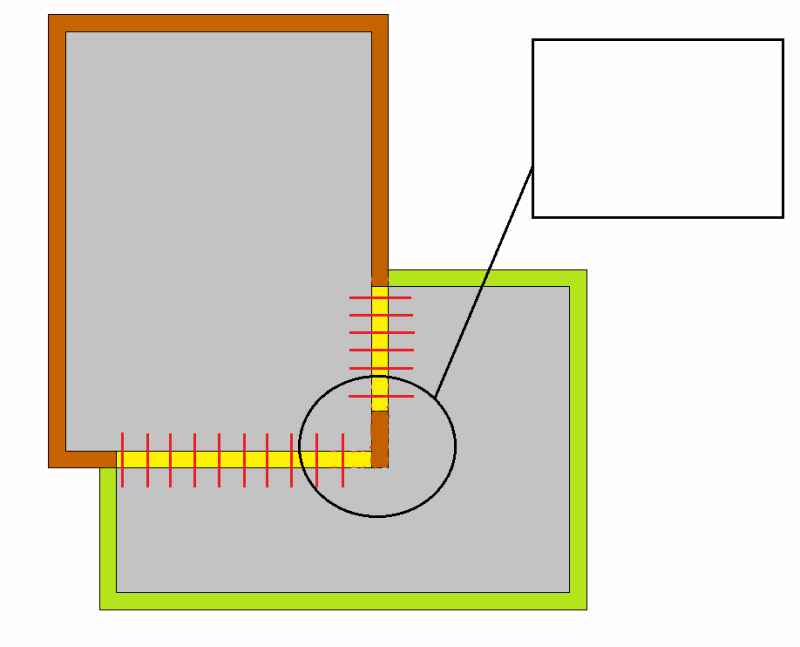

I dont have much experience with reconstructions so I hope my questions wont be silly. Id really like to know what do you guys usually do/suggest in situations like this.
I have to connect a new RC slab (140 mm thick) to existing RC slab (same thickness). There will also be some new openings (span 3 and 5 m) in existing masonry walls. Because of this I will design RC BEAMS where existign walls used to be.
I will connect RC beam/slab to an existing slab like this: drilling holes in existing slab, then epoxy + rebars.
What Im wondering is how to make sure that new stirrups has sufficient anchoring since existing slab is only 140 mm thick. Do you guys design stirrups by considering a shear flow between existing slab and new beam?
About connecting slabs together - I was thinking about doing it in the middle of a slab since slabs are 140 mm thick, but I d feel better if I could connect it top/bottom.
Is it ok that all shear gets transferred by relying on the reinforcing bars only? I would normally chip a bit into the existing slab so that a part of the shear gets transferred with bearing on it which means it isnt 100% relying on the rebars, but since im also adding a RC beam below a slab it can be problematic...
I will appreciate any suggestion, advice, photo or sketch.
Tnx in advance.

gmd255 - Design the epoxy/rebar dowel connection's size, location, and spacing based on manufacturer's (e.g. Hilti) recommendations. In a 140 mm slab, the edge distance ( <70 mm, at best) will probably be the controlling factor. Don't try to crowd too many dowels into the corner. This is self-defeating since drilling will make "swiss cheese" out of the existing concrete. Interference when drilled holes hit rebar in the existing slab will likely force field changes in dowel locations. A compromise on a reduced number of dowels may be necessary.
Take SLTA's advice for additional support at every edge where slab-to-slab epoxy dowels are used.
I have marked up your sketch to show what may be improved conceptual locations for slab-to-slab epoxy dowels:

Yeah, that's tough. You obviously can't provide standard hooks at the top of the stirrups. Nor will you likely be able to develop the bars for Fy/shear friction with the drill and epoxy install. A little off-reservation judgment might be required. Some options:
1) Try to design the beam as non-composite so that the stirrups don't have to be developed into the slab.
2) Use the bearing wall dead load as an effective clamping force for shear friction.
3) Choose not to worry about developing the bars for Fy into the slab.
I'd probably go with #3. I've seen some research that you can develop a fair bit of shear flow resistance even without any dowels.
Quote (OP)
I wouldn't sweat this. Just get your shear connection and accept that the joint may open up a bit. You could tool the joint so that it does so cleanly.
Quote (OP)
1) SLTA's approach solves this.
2) Were it aesthetically ok, you could widen the beam to provide a ledge.
3) A ledge wouldn't need to be but a couple of inches. Perhaps you could increase the cover on your beam stirrups so that a 2" ledge could be chipped into the existing slab.

At the re-entrant corner, I would likely treat the -ve moment as a fixed end condition of a propped cantilever and use a heavier bar at the centreline of the beams... maybe a single 25M (#8) and reinforce the balance accordingly.

I would want to chip out the existing slab to half the width of the wall. That will serve the dual purpose of providing for bearing for the new slab and giving you access to cast the beam. As to the stirrups, I would provide them with different leg heights, and 180 degree hooks on both.

tnx for replies! SlideRuleEra - I agree, good advice.
hookie66 - im having some troubles understanding what you suggested (English language is not my 1st language so I have so issues with expressions). Can you please pst a sketch? I d really appreciat it.

I think you guys were suggesting something like this:
RE: rebars as anchors - connecting existing and new RC elements
You interpreted my stuff correctly. You might need a little more stirrup cover on the one detail in order to do the drill and epoxy business correctly.
