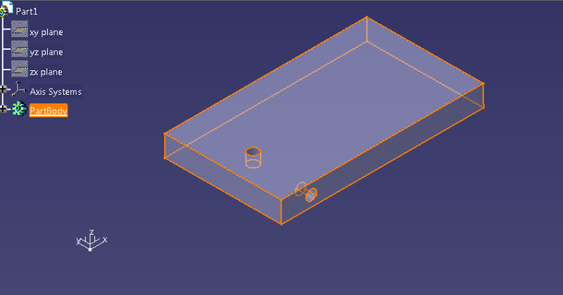

Hello,
I need to take an image of a CATPart, and then rotate the part (Only the view to see the oposite side of the part)in X 180º to take another image.
I now how to take the image. What I don't now, is how to rotate the model to rotate 180º in X.

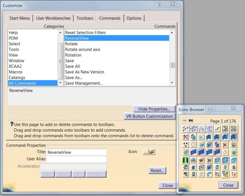

You can find it under View>Command list, or add the command to a new or existing toolbar.

RE: Take CATIA image and rotate in X 180º
But Reverse View, it looks only to rotate the part only in Z axis. I need in X axis.

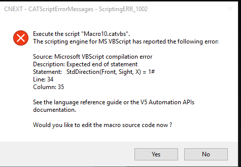

I think i found the one that you are talking.
I had inserted it in a vbscript and it returns an error...
But still have some errors..

In the original DS DMUInfEngineeringView.CATScript you need to change code
StdDirection(Custom, Sight, X) = -1./ Sqr(2)
StdDirection(Custom, Sight, Y) = -1./ Sqr(2)
StdDirection(Custom, Sight, Z) = 0.
StdDirection(Custom, Up , X) = 0.
StdDirection(Custom, Up , Y) = 0.
StdDirection(Custom, Up , Z) = 1.
' Engineering view do display
Dim iIndView As Integer
iIndView = Custom ' <==== To be changed on the different macros ====
with this
StdDirection(Custom, Sight, X) = 1./ Sqr(3)
StdDirection(Custom, Sight, Y) = 1./ Sqr(3)
StdDirection(Custom, Sight, Z) = -1./ Sqr(3)
StdDirection(Custom, Up , X) = 1./ Sqr(6)
StdDirection(Custom, Up , Y) = 1./ Sqr(6)
StdDirection(Custom, Up , Z) = 2./ Sqr(6)
'~ iIndView = Custom ' <==== To be changed on the different macros ==== this is original line, you have to change Custom with what you want as DS declare
iIndView = 7 ' <==== To be changed on the different macros ====
Or see if CATIA.StartCommand ("ReverseView") is more suitable for you.
Type in Power Input c:ReverseView
I did try that, but it doesn't allow me to drag/drop the icon in the toolbar......
Maybe the IT settings doesn't allow that!...
How about the other option (User Alias)? It the first time I see that, can you help me out in this matter, please?
I am not happy with its location...
