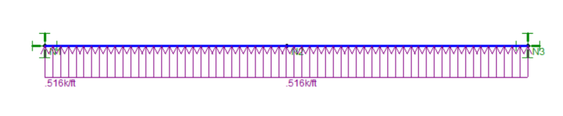

I have a simple span beam (wind column actually), spanning 60', uniform load, and input the W18x55 section from AISC database within RISA-3D. Single load case, the most basic of simple beams.
From RISA-3D: Max moment at 232 k.ft. Max deflection 7.3" at midspan.
Hand calc: Max moment at 232 k.ft. Max deflection 5.8" at midspan.
So I investigate RISA further, to explain the 125% deflection differences. I copy the file and in the new file manually define my Izz section props within RISA (890 in4 that equals the AISC value) and I get 5.8" deflection. Correct answer.
I am a somewhat new RISA-user, so I assume I am doing something wrong when selecting the AISC database within my model - does any one have any ideas on what I may be doing wrong?
I can attach the two RISA files, if needed.

Post a beam-loading diagram - might help me or others look at it with you.

Two sources for difference that I can think of:
1) Go to the Codes tab of the (Global) Model Settings. If you're using AISC 13th or 14th edition, then there is a flexural adjustment to stiffness (per Direct Analysis Method). This is approximately 20% and is intended to decrease the flexural buckling strength and column frames. In order to better approximate the inelastic buckling that steel frames actually experience. Though this is not intended to be used for service level deflection calculations.
2) The shear deformation setting which is on the solution tab of the (Global) model settings.

Thank you. Riddle solved. It was the DAM stiffness adjustment factor.
JAE and dik:
The loading was uniform:
Turning 'OFF' the stiffness adjustment the displacement is now 5.8".
