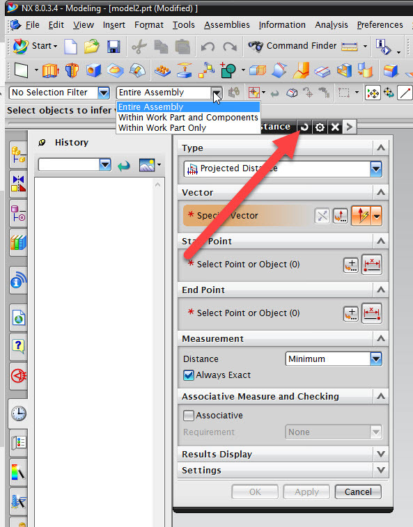

Using NX 8.0.3.4
The Measure Distance tool for Projected Distance has historically allowed me to select any vector in an assembly for projected direction by setting my selection filter to Entire Part. Yesterday, the options available suddenly changed, and I can no longer select Entire Part, only Work Part. This is for all Vector options, except for On Curve Vector, which for some reason still allows me to change to selection dropdown to Entire Part.
I do not recall changing any user preferences or customer defaults recently that I think would affect this. I was only alternating between different displayed and working parts/assemblies. The change is persistent and remains after restarting my machine and the software.
What's also strange is that I can run both a native installation of NX and a Teamcenter version (both are NX 8.0.3.4), and I can only select Work Part as described in both versions of NX. This makes me think something in my customer defaults have changed. I've checked those, and I have asked others in my organization if they are having the same issue, but everyone is still able to select Entire Part for Projected Distance inferred vector.
I really need to get back to allowing Entire Part selection for the Projected Distance inferred vector. Work-arounds by creating a datum in the work part are not going to be a long-term solution. Any ideas for what setting I may have changed?

I don't have NX 8 installed anymore, because it's more than five years old and completely out of maintenance at this point, but the only thing I can think of is the selection scope. Have you made sure that your selection scope is set to Entire Assembly?

Thanks for the suggestion, but that's exactly what I want to do and I can't. The selection dropdown populates with "Within Work Part Only" as the only option to select.

Are you working with the Assembly module toggled 'ON'?

Yes, I'm working with Assembly module ON. But I tried toggling the Assembly module on and off and that had no impact.
RE: Entire Part filter not available in Measure Distance
Try a reset of the Measure Distance dialog (see image).

I'd like to try the reset of Measure Distance dialog suggested, but the image link was broken in the post. Can you describe how to do this? Thanks!
Click the curved arrow icon in the title bar of the dialog.
Fantastic! Resetting the Measure Distance dialog did the trick. Thanks everyone!
