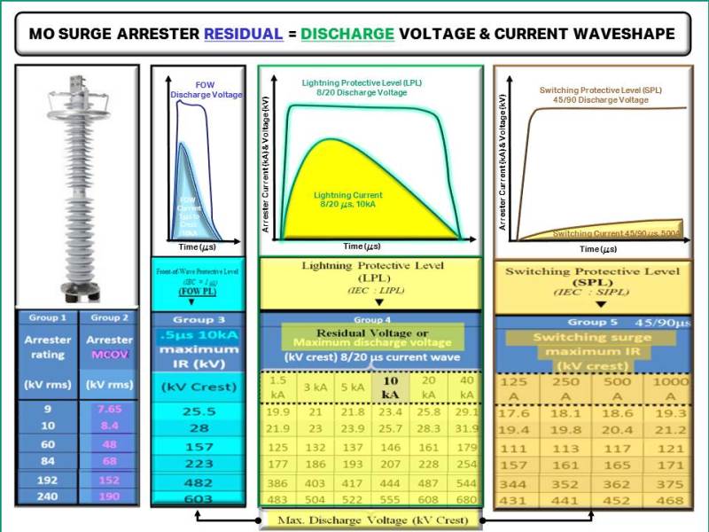

1. Why not based on wave at 30/60us and 1/..us? The 8/20 waveshape was chosen those many years ago and has remained the standard discharge current waveshape even though it is known not to simulate all lightning current waveshapes. As the understanding of lightning current waveshapes evolved, faster waveshape tests were introduced. To simulate the discharge current of a switching surge on a power line, the slow front and long tail waveshape was adopted.
2. Is there any other names for the a), b) and c)? Yes, the are associated with the protective level of the discharge or residual voltage waveshapes as follow:
a) 8/20us : Lightning Protective Level (LPL): is the discharge voltage resulting from a discharge current with an 8-10μs rise time. The IEC term for this is Lightning Impulse Protective Level (LIPL).
b) 30/60us: Switching Protective Level (SPL): is the discharge voltage resulting from a discharge current cresting in 45-60μs. The IEC term for this is Switching Impulse Protective Level (SIPL). NEMA in the USA stipulate a discharge voltage waveshape ranging from 45 to 90μs.
c) at 1/..us : Front-of-Wave Protective Level (FOW PL): is the discharge voltage with a rise time of approximately 5μs. The IEC equivalent to this is the steep current impulse protective level and is the residual voltage across the arrester resulting from a discharge current cresting in 1 μs.
See below supplementary information related with the surge arrester standard waveshape test and typical sample of surge arrester discharge voltage.
