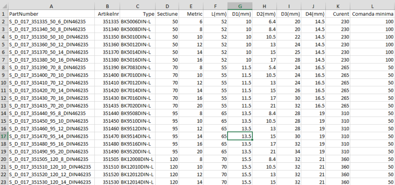

The correct way is to make a catalog from the original part.This part is linked with the excel file.When you resolve the catalog, all files (Catparts) will be created automatically with the specified name from the excel.
Check out the image below.
In my case there is a concatenation made in excel which defines the part name.
