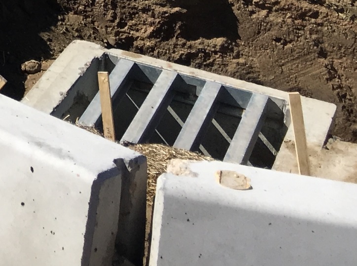

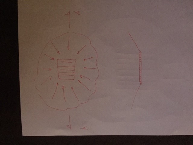

if I calculate the Q of a given area draining to an area inlet like the pic.
Inlet is standard install by county. Does this inlet have Q capacity?
RE: does storm inlet have Q discharge capacity?
The "capacity" will depend on how the grate is installed, and how much head is allowed, so there is no single value. A grate in a sump situation can typically handle more then a flush grate. From your picture, the grate actually seems to be raised above the surrounding ground, which could cause much of the flow to bypass the grate.
I'm guessing that you have an issue with the adequacy of this inlet? If so, more information is needed in order to provide meaningful feedback.

suggest calculating the capacity using the following reference and since this inlet is covered with some sort of filter, the capacity will be greatly reduced. suggest also using a generous clogging factor

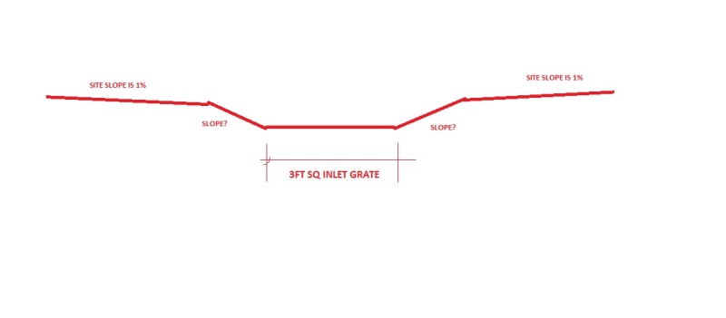

@psmart, the area surrounding the inlet will be re-graded see attached.
I just need confirmation that the inlet opening can take the Q I'm getting.

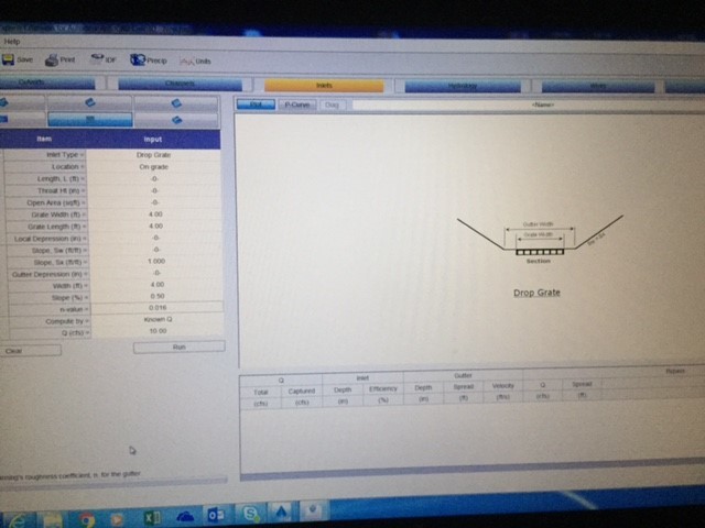

I have hydraflow inlet calculation software.
The inputs are very simple and basic. I just put the width and length of grate and my Q.
But I'm not understanding the output.

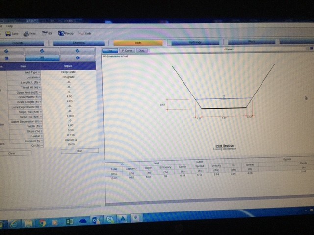

If you will look at the output picture, there is water above the grate inlet.
Why would there be water above grate inlet if the inlet was designed for Q?
attached are input and output pic from hydraflow
The inlet capacity will be a function of the depth of water "standing" above the inlet. Once the inlet is submerged the orifice equation is used to calculate the capacity based on the open area of the grate (less any assumptions for blockage). You can create a table of depth versus flow and then determine is the peak Q from the drainage area can be passed by the inlet at an acceptable ponded depth.

I run a table of depth/flow. What is the "standard" slope of sag?
I think I can play with this number because I'm re-grading the site but want to use "standard" practice.
aprons are usually 2% slope. dont worry about the open area, unless your depth is quite large, use the weir equation with the perimeter length as recommended in HEC-22. reduce the capacity to account for clogging, assume 50% clogged

Delagina,
You need to correctly fill out the input for hydraflow (not done in your screen capture). You should be able to use Hec-22 that cvg linked previously for a reference.
