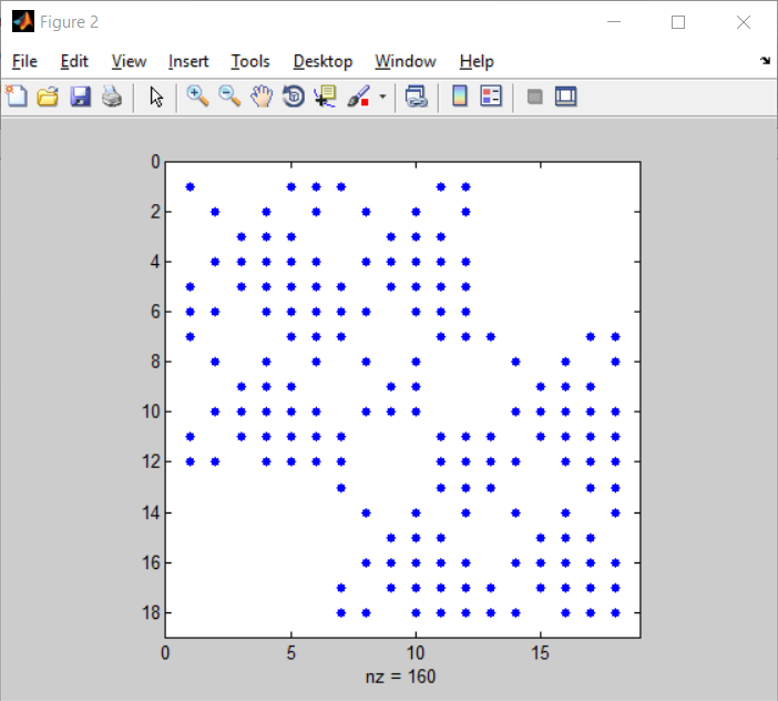

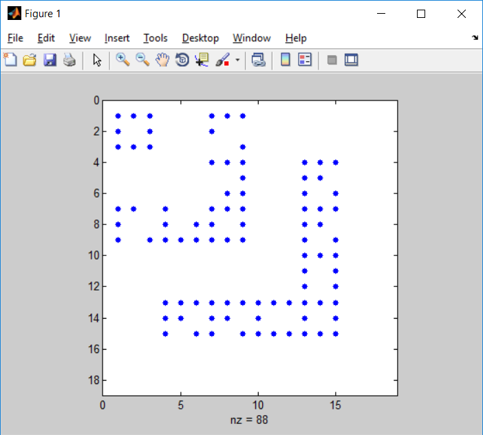

I didn't expect totally exact the same results, but the two results are totally different things.
I recover these two output mtx files. The data structure are different.
Calculix result
Abaqus result
I choose to believe abaqus result, and there may be some software bugs in ccx, or I used ccx with a wrong way.
The stiffness matrix is attached as below.

Yea that is suspicious. In CCX's matrix, the displacement DOFs in each row don't sum to zero which seems to indicate there's some constraint to ground when there shouldn't be. For Abaqus's matrix they do sum to zero.
There have been bugs with beams and shells in CCX related to the way it converts them to solids internally. If anything was going to work right, it would be solid elements.
