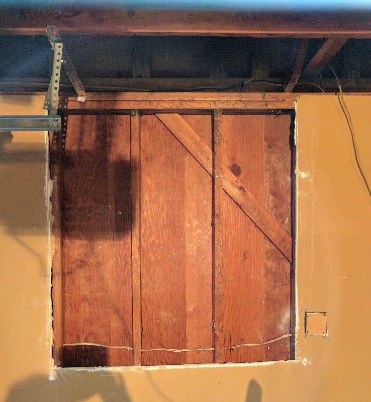

Installing Window in shear braced stud wall
RE: Installing Window in shear braced stud wall
I would guess that the brace was a temporary construction convenience and that the sheathing is now the bracing element in your wall.

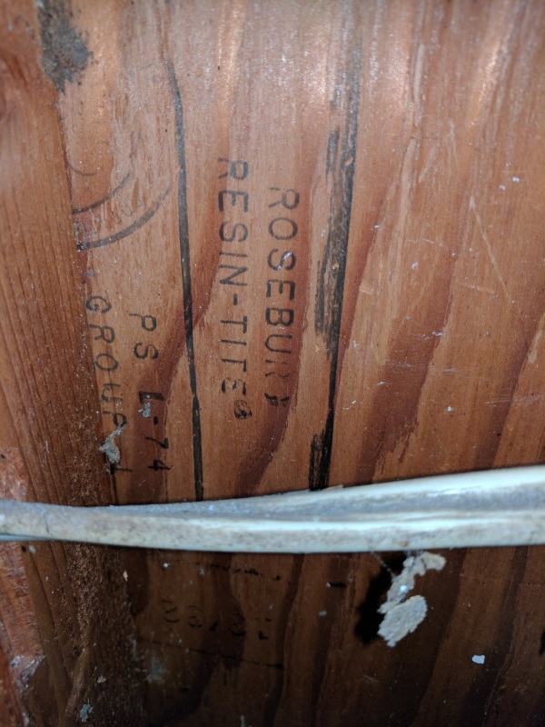

The sheating is stamped "resin-tile". I am assuming it's not structural thus the bracing.
Looks alot better than the cardboard that they use to brace tract houses.
I would not worry about losing the brace.
