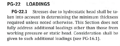

The boiler is an economiser (water tube boiler). ASME-I doesn't explicitly mention sagging or bending stress, however, looking at PG-22 Loadings it requires to consider any additional loading, hence bending stress needs to be considered.
Again, I can't find anywhere on how to consider it in ASME-I but I have found out that it's being considered in B31.1.
