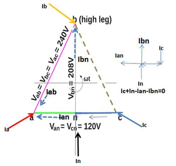

If” line currents for multiple single mid-tap transformers” it is about open-delta with high-leg 240/120/208 V then the equations are as following:
[Usually what is known are the entering currents :Ia,Ib,Ic and In and has to be calculated Iab,Ian and Ibn.]
in point a: Ia+Iab+Ian=0
in point b : Ib+Ibc-Iab+Ibn=0
in point n : Ic+Ibc+In-Ian-Ibn=0
Let’s put Ibc=0 and Iab=x;Ian=y;Ibn=z
Then:
Ia+x+y=0
Ib-x+z=0
Ic+In-y-Z=0
RE: Unbalanced Delta Delta Transformer Load Calculation
Sorry. Since I forgot z in the last equation the result is wrong. It seems it is no solution in this way.blush

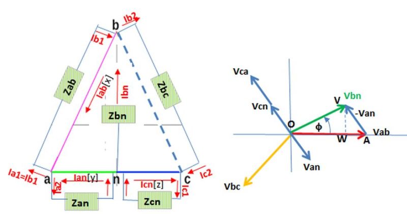

Actually we don't know IA,IB,IC and IN but Ia1=Ib1,Ib2=Ic2,Ia2,Ic1 and Ibn according the
attached diagrams:
In this case it is possible to find Iab[x] , Ian[y] and Icn[z] as following[neglecting the voltage drop in the transformer windings]:
Ia1=Ib1=Vab/Zab Vab=240<0
Ia2=Van/Zan Van=120<-60
Ib2=Ic2=Vbc/Zbc Vbc=240<-120
Ic1=Vcn/Zcn Vcn=120<-240
Ibn=Vbn/Zbn Vbn=208<30
In order to calculate Vbn:
VW=120*sin(60)=103.9
OW=240-120*cos(60)=180
OV=SQRT(VW^2+OW^2)=207.8
=asin(VW/OV)=30
Iab[x]-Ia1-Ia2+Ian[y]=0 in point a
-Iab[x]+Ib1+Ibn-Ib2=0 in point b
Icn[z]+Ic2-Ic1=0 in point c
then:
Iab[x]=Ib1+Ibn-Ib2
Icn[z]=-Ic2+Ic1
Ian[y]=Ia1+Ia2-Iab[x]
It is a very sophisticated way, indeed, so I think the waross way is preferred, any way.

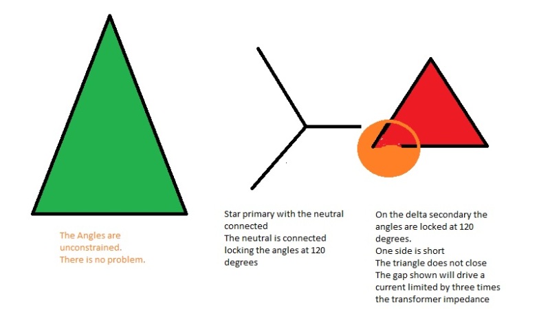

In the sketch, the green triangle shows a delta:delta or a star delta with a floating neutral. The voltage is low on one phase. The phase angles adjust to compensate for the uneven voltages.
The second sketch shows a star connection with low voltage on one phase.
The neutral is connected and this locks the phase angles in at 120 degrees.
One side is short on the delta secondary.
A couple of effects when a four wire wye:delta is used on a distribution circuit.
If one primary phase is missing, the bank will back feed that phase.
If two primary phases are missing, the two open phases will be back-fed with approximately 50% voltage. On a mixed, industrial and residential circuit, this kills refrigerators and freezers.
A line to line short will be back-fed and the fault current will be twice the expected current.
When I had responsibility for the small system it took me a couple of years to get rid of the star delta transformer banks.
Once the star-deltas were gone, there were no more refrigerator burn outs in the community.
