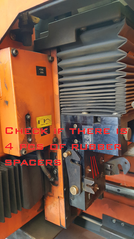

We had the same problem
1. Check if there is a rubber spacers next to your head. See photo below.
2. Check if your laser head clamps, clamp head firmly. We have changed those.
3. Ceramics in laser head can be broken or with cracks. I suggest to change it to new.
4. Check if O2/N2 filters are clean.(Next to intake gauges)
5. Couple of mirrors in resonator or along the path could be weared off, dues to age or bad cooling.

1. Check if there is a rubber spacers next to your head. See photo below. Yes

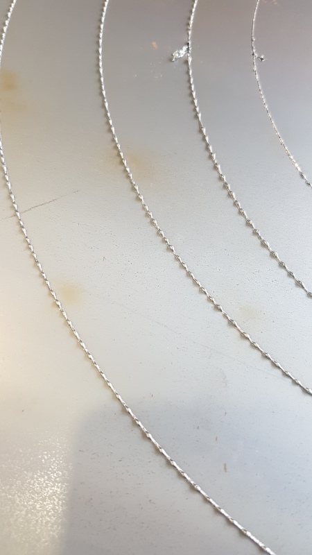

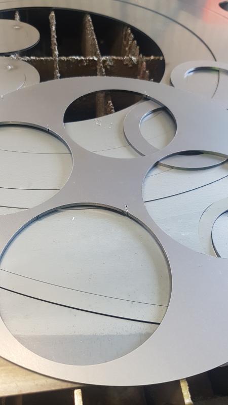

To give you a visual on whats happening.
The first pic is the underside of 3mm Carbon steel as you can see it's a clean cut. No dross, no small beads. The type of cut quality we all want. The other pic is the other end of the same sheet with the same settings and look at it. In need of a hammer to get those parts apart then a clean up. Now the funny thing about this time is it is only happening at about 3/4 of the sheet. It has done this on the last 3 sheets cut but not the 4th. ( Insert, Bangs head against wall smiley here ). To look at that I would say it needs a nozzle alignment but the sheet before that point and after that point are as good as the fisrt pic.
It's got a new lence, new ceramics and the nozzle is centered. Can't see how it changes so dramaticly and only in that spot.
I tried adjusting the focal length as the cuts get to that part of the sheet and it cuts perfectly again but then returns to crap as the focal is out when it moves further over to the last quarter. So a quick change back and it's fine. So it looks like the focal length is changing with the moving of the bridge. But as I said above it's not doing it now. Might need to get our tech guy back out. Problem is it never does this when he's here. And we all know how hard it is to find an intermitent fault.
Thanks for the advice and help on this. I will keep it updated if I finally knock this Gremlin on the head.

Looking at those pictures I think you loosing power somewhere. I had similar problem on my Trumpf. It could be lens, it could be RF Tube or driver stage.
