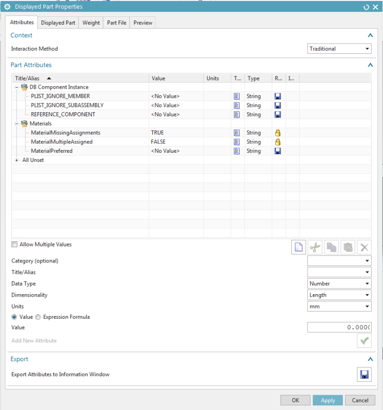

Thank you for your help but I can´t find a way to do it.

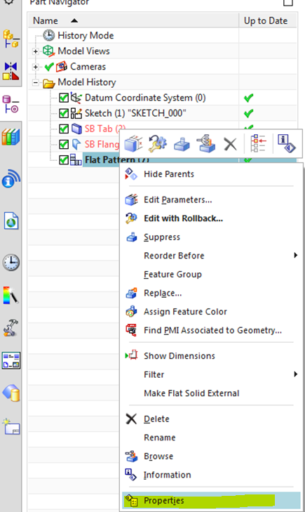

My steps are:
1. Create a flat pattern view
2. Go to the properties of flat pattern:
3. Properties of model.prt
I can´t see any place to link any expressions.
Airin
NX Designer
RE: Getting attributes from a feature
NX 11 changed things up a bit. There are two "radio" buttons above "Value", choose the "expression formula" option. The "Value" text entry will change to a drop down entry, choose the "formula" option from the drop down and then pick the feature's attribute expression.

Thank you Cowski,
Done!
