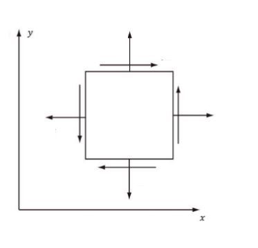

Just remember that shear is essentially non-directional....think about your little square force/shear element:
So any piece of deck within your diaphragm simply sees "shear".
But for load path into collectors and braces you need to break it down directionally.
