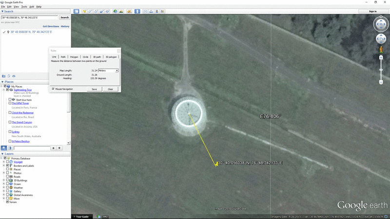

As mentioned earlier, Google Earth's imagery registration may be poor if you're not in the US or Europe. This site: http://www.uni-koeln.de/~al001/airphotose_files/hs... discusses how you can check the imagery registration. I've done that for Chandigarh VOR-DME http://ourairports.com/airports/VICG/pilot-info.ht... and the error is around 31 m:
