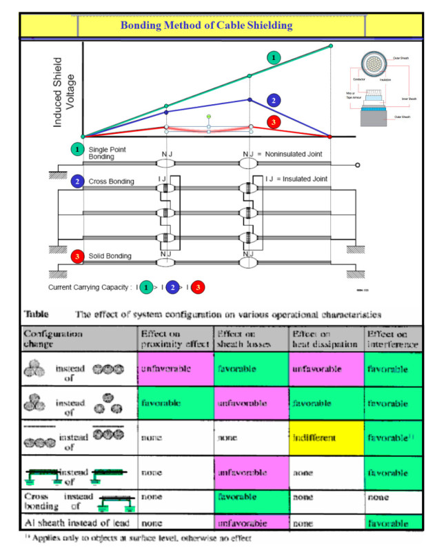

Power0020, there are fundamentally 3 types of HV power cable shielding method: One end-grounded,both ends-grounded and cross bonding. Sometime variation with surge arrester (shield voltage limiters) are used. Below is an excerpt from various sources captured in a table and a generic plot with additional info of cable performance for flat and trifoil configuration.
Hope this help.

Great as usual cuky2000, many thanks for that. I know the shielding by its other name, sheath bonding!.
May you please upload the photo in a file form, the text is unreadable.

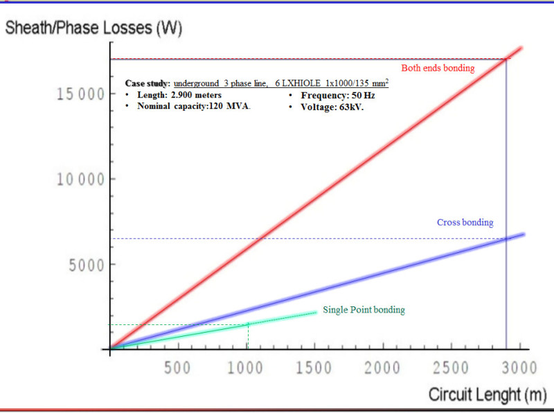

I understand that the cross bonding current rating is equal to the one with single point bonding.
I assume that it can go less than the single point bonding in case of unbalance in minor section lengths raising some circulating amps?
RE: Running MV/HV Cables in Flat Formation vs. Trefoil
Hi Power0020: At difference than the cross bonding, there is not current path to ground (earth) for a single point bonding. However, in both cases there is Eddy current but this is much smaller than the circulating current. This can be reflected in the cable losses shown in the generic graph below.
Per your request, a readable pdf file is uploaded.
