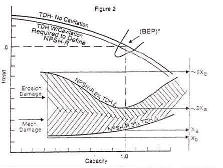

Please remember that NPSH relates to 3% headloss. Onset of cavitation can occur at much higher values and tends to be higher at both left hand and right hand end of the curves. Ask sulzer for the 0% / onset of cavitation curves.... So don't be too fast to dismiss cavitation until you get the data.
might be something like this
