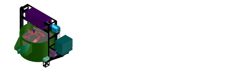

I'm planning on designing a centrifugal fan that will blow air for combustion of charcoal which is contained in a cylindrical drum but I need to know how to estimate the system resistance (the static pressure) and the flow rate.
Please, I'm new to fan design and I don't know how to get my fans flow rate and corresponding static pressure too. I don't know if there is a table where I can get further information to help in the design process. I've attached the complete design image of my machine for more understanding of what I'm trying to achieve.
Thanks.

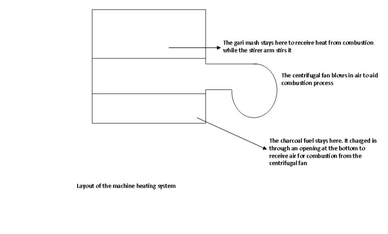

Thanks everyone and sorry for the late reply! This is what I decided to do after reading replies and I want correction if needed: I calculated the pressure offered by the charcoal height and used it as the static pressure resistance of the system. I had previously determined the quantity of air required to burn the total mass of charcoal of 27.78kg which is 236.3m^3. Then, I assumed that the quantity of air will combust the charcoal mass in 40mins. From there, I determined the flow rate required to achieve this which is 0.098m^3/s and I based my fan design on this two parameters.
For more details about the machine:
The machine is design for frying Gari. As described earlier it has a cylindrical compartment for storing charcoal. The Gari mash is held by a pan separating the combustion chamber from the fring chamber where frying takes place with the help of a mechanical stirer.
The image belows shows the outline of the heating system in simple diagram
