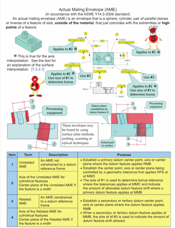

Picture from Tec-Ease website

"Applies to #2*" note is shown on both callouts: position RFS and also on position at MMC
What do you think?

No, that does not mean position at RFS can't be interpreted in terms of surface of feature. As mentioned by AndrewTT and in the other thread, there are ways to verify this type of callout without taking the axis of the feature into account.
My statement from the thread where some of the differences between ISO and ASME systems were discussed was of a general nature. I think we will agree that the Y14.5 standard, as is now, strongly implies (for example through the wording of paras. 7.3.2 vs. 7.3.3.1) that the only way to interpret position tolerance at RFS is to use axis interpretation.
