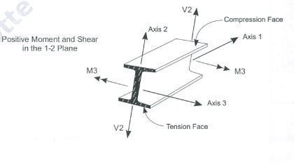

Hello
Could someone tell me how to know the directions in ETABS ? like sometimes it says bending moment 1-1 or 1-2 or 3-3
But how to know which one to use or what is the meaning of each notation ?
RE: Directions in ETABS
Have a look at the local coordinate system, where directions 1-2-3 are defined.

For beam: Bending Moment M3-3
Shear V2-2
