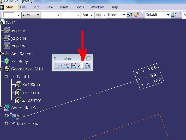

I need to automate the creation of point coordinates annotation in the FTA workbench in CATIA. As far as I have been able to find out, DS has not exposed the method for creating coordinate dimension. Is there anyway we can do it?
Attached is the screenshot for what I need
Thanks for all your help. Please let me know if you need more information.

Thanks for your reply. I know the option you are pointing out is available in CATIA. The reason I want to automate it is because I am copying a number of elements from one file to another. when these elements are copied, they need to be annotated with the coordinates of the points. this is a new process we are implementing and the designer will not have enough time to annotate the points manually. so we are creating a utility that let's the designer do it at the click of a button.

yes Ferdo we tried that. We measured the coordinates of the point and entered them as a text string. However, here the problem is that the new annotation is no longer associative. that is, it does not change with the change in the location of the points and we have to re-run the code once again to re-create the annotation for it. How can we achieve the solution here?
RE: CATIA Automation
So you copy the points in and can later change the coordinates of the points that were copied in?
If you want the annotation to update you need to make length parameters that are tied to the coordinates of the points, then attribute link those parameters to your annotation.
You can create three length parameters (X,Y,Z) using the .CreateDimension method
You need to create a formula to tie the point coordinates to the three parameters using the .Relations.CreateFormula method and KWE "Point->coord(rank)" (where rank = 1 for x, 2 for y and 3 for z) for the formula.
Once you have the parameters associated to the point coordinates you can attribute link the text using the .InsertVariable method.

Here's what I got, worked well.
CODE --> VBA
'Paste into Visual Basic
'Open a part
'Second geoset in the Part must contain the points (you can change this)
'Run the macro
'Macro will:
'  -Loop through all points
'  -Create XYZ parameters under the point
'  -Create a formula for XYZ parameters so they equal the location
'  -Create an annotation set and view parallel to the ZX plane (you can change this)
'  -Create annotations for the coordinates
'If you move a point on surface, the annotation updates to the new point coordinates
'*If you run it twice it will put more parameters under the points
