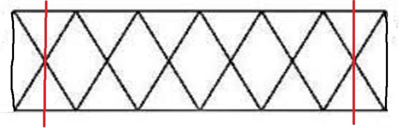

Any particular reason the center needs to have that big hole? How about turning the whole thing into a diagonals truss block?
Something like:
Also I believe you can use filled nylon in a 3D printer for a bit more real feel. You would want to use steel nozzles instead of brass.

Thanks for those tips. The reason I cut away the centre from the distal end was to hopefully save a bit of material and to aid faster cooling times. But since that's worked against the stiffness of the part, what I've decided to do is make it to the external shape as the old one, beef the I beams joining the two ends up from 7mm to 10mm and see how we go. I'm still saving about about 20% on material which is pretty good.
Quote (itsmoked)
The centre has to be hollow to allow another part to pass through although the hole can be made smaller.
Quote (John2025)
Yes the plan is to make a 3D printed part the same as the old one but with hollow walls to see if that is a good compromise.
