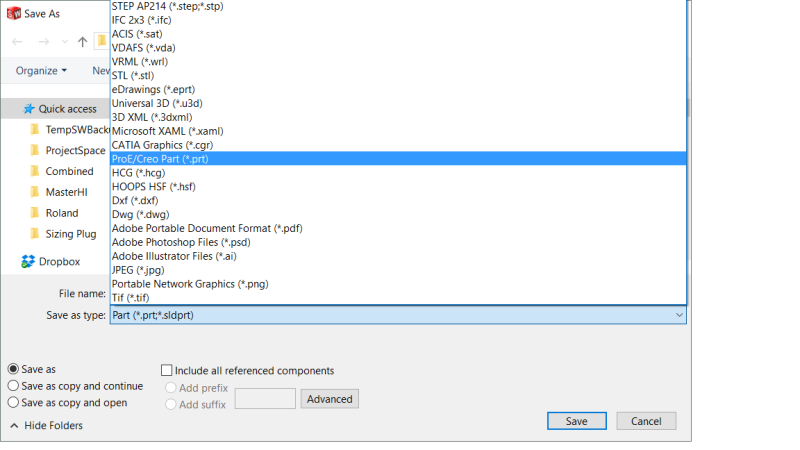

Can't just sent a STEP file?
Or Save As?

That is only a shorthand way of sending a dumb solid. To my knowledge there aren't any parametric file translators, at least nothing I could afford!
I want them to have a parametric file so they can easily modify the geometry.

SW can import Creo with parameters, but it can't export. Perhaps Creo does likewise?
The big risk is that the import may not support more advanced features like equation-driven curves. Probably better to create new in Creo.
