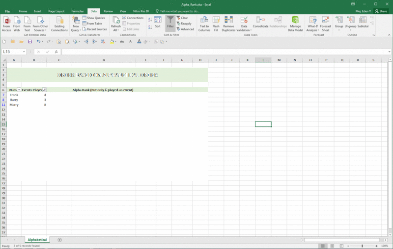

Hey fellow geniuses,
Just wondering if there is a way to rank in alphabetical order, a list of names but only if a value in an adjacent cell is greater than 1?
On the attached worksheet, I would like to rank the names that have a value in row B greater than one, while ignoring the names that have “0” or are blank.

Based on a reply here: https://www.mrexcel.com/forum/excel-questions/6222...
In cell I7 enter: =IF(B7<1,"zzzz","")&A7 and copy down
This will add "zzzz" to the front of any name with no events played.
Then in cell D7 enter: =IF(B7>=1,COUNTIF($I$7:$I$11,"<"&I7)+1,"") and copy down.
This will rank the names in column I, and return just the rank for those with a value >=1 in column B.

This is how Doug's formula would look in a Structured Table...
D7: =IF([@[Events Played]]>=1,COUNTIF([Name],"<"&[@Name])+1,0)
...or with a different aggregator, which I prefer...
D7: =IF([@[Events Played]]>=1,SUMPRODUCT(--([Name]<[@Name]))+1,0)

This is becoming a lot of work for something that can be done simply and easily and still leaves lots of options for future; this is the power of a structured table, see attached.
In a structured table, to achieve the results you are looking for:
After converting your spreadsheet to use a structured table the results you are looking for can be done in 4 easy, quick steps.
1) Click the Events Played Pulldown arrow and Sort Largest to Smallest (For some reason if you skip this step, the end result will not be the same.)
2) Click the Events Played Pulldown arrow and deselect "0" in filters leaving only rows with a positive number in this column.
3) Click the Names Pulldown and Sort A to Z
4) Click the Events Played Pulldown arrow and select "0" in filters (all numbers available now)
Viola!
I've taken the liberty of adding win/loss and avgerage stats to give you something to look at and play with. Give you an idea(s) of what you can do.
To add names/people, just enter the name and relavent stats in the row directly below the table. It will automatically be added to the table, no need to "ADD" rows to the table first.
PS) I did add a couple new names, and the win/loss stats I pulled out of thin air.

dbill74 - Adding the modified name column and the rank formula doesn't take very long, it's a one-off operation, and it works well in conjunction with the structured table:
- It provides the alphabetical rank number, which is what the OP asked for
- You can update the number of events played for any player and the rank updates automatically
- You can sort on the modified name column in a single operation
- You can insert new rows and the modified name and rank formulas are generated automatically.
Spreadsheet with formulas attached (using SumProduct, to keep Skip happy :))
