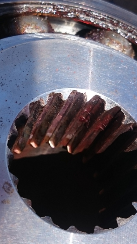

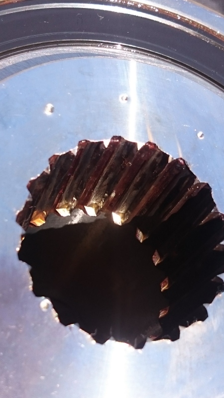

I am having repeat failures of a splined coupling. The system consists of belts and a pulley driving a splined input hydraulic pump through an adapter that is flanged on one end for the pulley and female splined on the opposite for the pump. The splines keep fretting away to nothing. The system came packed with a moly paste type lubricant that quickly gets hammered out of the connection. We switched to an EP grease which quickly gets centrifuged into base oil and thickener. We tried a gear coupling grease, Kop-Flex KSG, which was too thin and passed through the coupling too quickly. There are no seals. We have settled on Mobilgrease 28 which has enough viscosity to stay in the coupling and is stabil enough to make it to a reasonable lubrication interval. We are still getting some random failures here and there, though.
One thing I have noticed is that the female spline is not hardened. A center punch leaves an indentation similar to A36 steel. We are thinking about making our own adapters and matching the hardness of the pump shaft.
However, I have seen that it might be possible to use an anaerobic adhesive to make the coupling rigid and eliminate fretting corrosion. I am interested in pursuing this route and just wanted to see if there was any experience with it here.

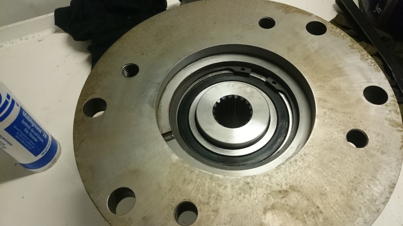

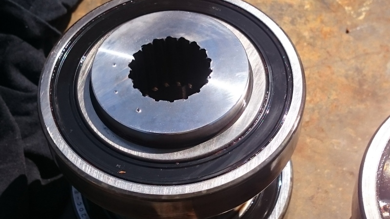

There is a driver which is supported by two deep groove ball bearings between the pump shaft and pulley.
RE: Splined Shaft Coupling Issues
If I am understanding what I am seeing, the manufacturer has done an amazing job restricting the movement of the splined connection, being that the hub is supported by 2 generous bearings. But a clearance fit splined connection should be allowed to find "home". With this current set-up that will require the run-out of that spline to the bearing surface to be perfectly controlled, even a few thousanths run-out will grind the spline away rapidly, any ideas on how to check that spline run-out to those bearings?
On a side note, I think they already knew they had a problem, it seems highly over-designed.

I see the two radial bearings that carry the radial load from the belt, so I can't see a change in spline form as helpful.
I'm assuming that the olive drab colored adapter shell is fairly stiff, and equipped with a pilot for the hydraulic pump, so misalignment or mispositioning of the shaft vs the hub is likely not a problem.
Which leaves hardening of the female splines. I doubt that an experienced manufacturer would forget to do that, though a manufacturer's Supply Chain Manager might eliminate the process step in order to 'save time'.
I suggest you have some hubs made with hardened internal splines, or find a coupling hub with hardened splines and get a machinist to join the splines from the hard hub with the remainder of the OEM hub, with Dutch pins or other keying scheme.

When it comes to spline failures, typically the hardest surface wins. I caution the conclusion that it is a hardening problem, maybe on a one or two case basis, but continually? either way it is easy to rule out, so I agree with Mike just verify that if you haven't already.

For the running clearance, the pump does fit the green colored housing with a register. Some of the bearings have spun in the housing resulting wear to the housing. The wear becomes obvious as it causes uneven tension of the 6 drive belts. The housing wear is on the magnitude of 0.015mm by the time we see changes in belt alignment. The nominal size is 130mm. We have not seen any change in spline wear rate in the worn housings. I am having the worn housings hard chromed to restore the ID. I have specified an H7 fit for the repaired housing.

Some of the pictures appear rather dry and lots of red fretting debris is present. I wonder if weekly re-lubrication is possible, or an oil bath or even total-loss oil lube could be arranged.

Ok, got the pieces hardness tested. The driver is 29 HRC, possibly 4140, and the pump shaft is 50 HRC.
If it is 4140, then you could just take the replacement part and have it hardened to 40-42 HRC. But I definitely think going about 45 HRC could expose your pump shaft to significant wear.
