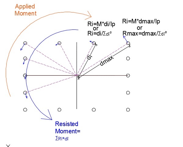

I been working with the center of rotation to estimate the reaction on bolts groups with the expression Ri=M*di/Ip. Where M:Moment, di: distance from center to bolt and Ip: Polar Inertia.
Ip=Ix+Iy
Ix=summation(A*dyi^2)
Iy=summation(A*dxi^2); (Parallel axes Inertia, but ignoring bolt inertia for being small)
My doubt begins while trying to match the acting moment with the resisted moment by the group by using the following
Resisted Moment= summation(Ri*di)
My reactions are pretty smalls and the resisted moment is also small. But makes no sense with the applied moment.
I also tried to decompose the forces by axis thinking that i had a confusion when measuring the distance directly from the center of rotation to each bolt center.
There is another approach which takes reactions as follows:
Ri=M*di/summation(di^2)
This method obviously match the applied with the Resisted moment, but i think that this method is just an extension of the Resisted Moment expression stated before.
Am I getting it wrong? is it Ok to have relative small reaction because the Ip? Any guide?

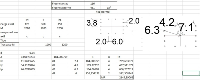

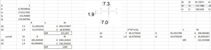

This is my case but i'm working with SI units. M: 1200 kgf*cm; so measuares are in cm. The excel are the calculations and the Resistet moment is MR (Momento Resistido)
I'd try 2 schemes one with nails and another with bolts. The Nail pattern has a greater Moment reaction than the applied, but i don't want to push really hard against normal fiber of my wood member (Just for precaution, i know how to control splitting).
Then when i tried the bolt group the Resisted moment was critically low and the approach begins to seems strange to me.

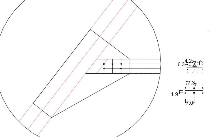

This are my members:
This are the results
for nails-
For bolts-
And the scheme of reactions-
Both approaches are widely used today (Example, AICI and Australian wood code) but the results are differents. Even when those are trying to explain the same response.
The Ri=di/summation(di^2) has it's origin on glued members, while i don't know where the Ri=M*di/Ip method came from but it's similar to beams equilibrium. Non of the methods consider any deformations of the members or the fasteners, any way both should be conservative(¿er?) than an instantaneous center of rotation.

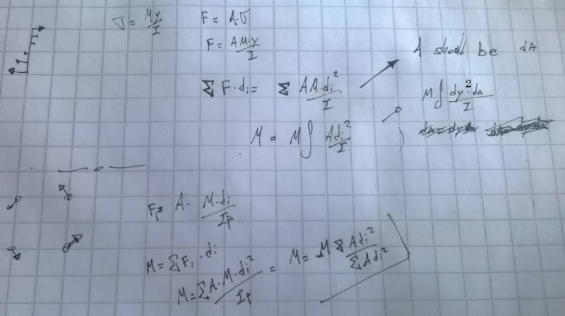

Thanks for the answers, after arranged my doubt i solved it. My mistake was to consider that the first method was retriving me a force, instead this returns shear stress applied on the fasteners. So the force should be Ri=A*M*di/Ip; Then M=Ri*di match the acting moment.
