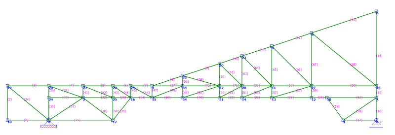

Problem: Remove a 2”x4” Beam and replace with plywood.

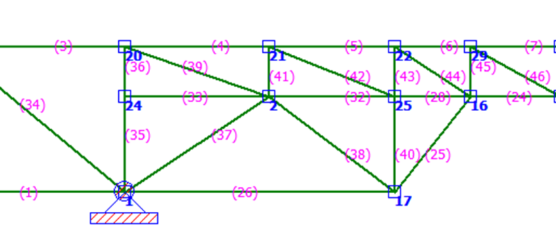

Shown below is a section of truss I have been working on.
The problem is the spacing between the top and bottom chords is too small for a diagonal member. So I have elected to replace the diagonal member with plywood. I have the axial, shear and moment forces acting on beam 39 (the beam to be replaced) and I have been able to convert the axial and shear force into X and Y axis force to determine the loading on the plywood. However, I am having difficulty determining how to distribute the moment forces in the X and Y axis or even evaluate the moment stresses on the cross section of the plywood and this is where I need guidance.
Nodes
2, 24, 20, 21
Beams: Southern Pine Grade 2.
33: 2”x8”
36: 2”x4”
4: 2”x6”
41: 2”x4”
Beam 39: Southern Pine Grade 2.
Node 2:
-978 Lbs Tension; -11 Lbs Shear; -135 In-Lbs Moment
Node 20
978 Lbs Tension; 14 Lbs Shear; -198 In-Lbs Moment
Additional Considerations:
The open space between beam 4 and 33 is 2.5 inches. My intent is to rip a 2x4 down to 2.5 inches and glue that piece to both the top and bottom chords then glue and nail a continuous plywood gusset to both sides. I have also considered sandwiching a 20ga plate between the beams and the plywood if the stresses are too great for ½ or ¾ in plywood.

Additional Information.
Beam 39 is just 1 beam of 18 beams which needs to be replaced. This beam was the first beam to consider when working from left to right.
On the side issue, with respect to beam 33, here are the loadings.
Beam 33
Node 2
-308 Lbs Tension; -198 Lbs Shear; -3138 In-Lbs Moment
Node 24
308 Lbs Tension; -201 Lbs Shear; -2102 In-Lbs Moment
Again, the question is not about the structure; but, how to determine the moment stresses in a plywood cross-section so I can determine the plywood loading on the remaining 17 beams.

I'm confused. Are you loaded at the nodes only, or do you have loads applied in the middle of members?
I thought trusses were composed of 2-force members loaded at nodes. If you are pinned on both ends, then how are you carrying moment?
RE: How to determine moment stresses in plywood cross section.
Joel,
I think he is analyzing the structure as a frame, not a pin jointed truss.
bluestar,
I understood your question well enough, but thought you were dealing with a design problem, not an existing structure. The answer is not clear but is likely dependent on how the moment gets into the plywood. Truss plates on the face of the plywood will engage only one or two plies.
BA
Hey Joel,
All loads are nodal loads and there are no middle-of-member loads.
All nodes are fixed joints in lieu of pinned joints; thus, transmitting moments.
Hey BA,
Yep, I am analyzing the truss structure as a frame.
Yep, it is a design problem.

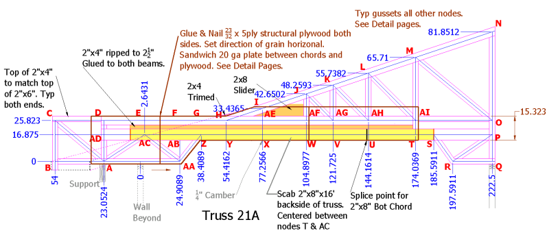

Conceptually, the plywood plate will be glued and nailed continuously along the top and bottom chords thus transmitting all forces continuously between the chords and through the plywood plate. The strong axis of the plywood will be running horizontal. I would expect all plies of a plywood plate, parallel to the load, to carry load when the plate is mounted with glue and nails as in the case presented above. The load capacity of the plywood will be considered in two ways: via the parallel-ply section and via full-thickness section. I just need to convert moment into cross-sectional force and to determine which way to apple the force vector to complete my analysis.
Does the plywood plate extend from B4 to B33 and from B36 to B41? If so, I'm not sure that your frame analysis is appropriate because B4, B33 and B39 will be acting as a single member with axial force, shear and end moments. Conservatively, the force to be taken by the nails and glue on B4 and B33 would be the sum of end moments divided by the height. Nails and glue on B36 and B41 will carry the panel shear.
BA
Correct, the plywood will extend over all nodes.
Agreed, the section, with plywood attached, will act as a single integrated unit. Under this premise I had considered evaluating this section, and all adjacent sections, as an “All Plywood Beam” under the provisions of APA Supplement 5-12 with the exception of substituting sawed wood for the plywood flanges. An initial review of the document suggested a less conservative approach than the one initially under consideration. However, I may return to this option.
With respect to the moment stresses in the plywood, I had already considered your point of dividing a length into the moment to derive a force; however, I was unsure as to which length to take. I considered the full width between B36 and B41 because the plywood was continuously attached and would dissipate the moment into the chords. The other more conservative approach, as you had mentioned, was to use the height which is what I elected to do. However, when considering the height I was unsure as to which height to use, the height of open separation between the cords 2.5”; or the height between the nodes 9”; or the height between the closest course of nails between the chords 4.5”; or finally the distance from the node under consideration to any one of those points. Another factor affecting my considerations was do I divide that length by 2 because there was another moment at the opposite end also inducing force on the plywood.
All of the above considerations led me to post my original question. If the length could not be ascertained with any degree of confidence then I started to consider the moment stresses in the plywood. This was easy enough to do by taking the moment and dividing by the section modulus; however, I could not find any performance data on edge stress on plywood. Although, I am now beginning to wonder if I can apply the plywood “Shear-Through-Thickness” capacity in (Lbs/Ft) to the problem. If I divide the moment by section modulus I get PSI then if I multiply by the section thickness I get Lbs force and to get the final capacity I would multiply times the length and then again which length.
I have thrown several considerations out for comments and would appreciate thoughts or other approaches on the matter.

I was trying to keep the question as simple as possible; but, perhaps I should present the entire truss for clarity sake.
Configuration for Analysis
Internal Member Stresses
Configuration for Fabricate
1. Yep, as shown, B33 is part of the bottom chord and the diagonal members you referenced frame for a raised ceiling profile. Although, I have found those diagonal members do carry non-trivial loads.
2. Yep, I have tried many truss configurations and have found that only a composite beam has the capacity to handle the loads on and around Nodes 29, 16, 3, 15, 35 and 34.
Just as a side note; I had considered attaching a 10’ panel centered on the nodes mentioned above. At the butt joints between panels, the assumption was that there would be a discontinuity in the transfer of moments; however, all of the moment in one panel would end at the joint and the balance of stress would be transferred to the chords. Also, beyond the ends of the 10’ panel the calculated moments were not as critical. No splice plates were considered, in that the plywood panels were nailed to the TC & BC with only 2.5” separation and that will be filled. I have evaluated the shear, tension and compression, both parallel and perpendicular to the direction of veneer grain and loading falls within the adjusted capacity of the plywood. However, moment forces are still under consideration and it is the moment on B45 at nodes 29 that gives me grave concern, (5,963 in-Lb).
3. These trusses have to be fabricated on-site; because the site is quite remote and to access the site one must cross a low load-limit wood bridge and must navigate very narrow roads with very tight turning radius curves. Additionally, from what I have seen, on-site application of metal plates connectors were dangerously far from optimum which is why I elected to go with glued & nailed plywood gussets. The assumption that moments would be transmitted through the gusset plate was based on the consideration that if the loads on the gusset plate did not exceed the capacity of the gusset plate then the moment was transmitted. I would not make that assumption with common metal plate connectors. I also felt that by using moments in the analysis produced a more conservative design specifically with respect to buckling stresses in the beams. Is there a fault with this logic and if so please do advise?

Agree. FYI, as my design process progressed I removed the diagonal members because of the narrow space between the chords and replaced them with plywood sandwiched with a 20ga plate on one side. Then after performing numerical analysis I decided to combine the TC & BC into a box beam just as you have mentioned and as KootK had noted.
Also, you had mentioned interest in how the connections were to be fabricated, to answer that question I attached a draft of the fabrication drawing to illustrate those connections. Of course, any comment is certainly welcome.

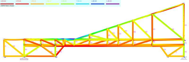

Yep, the bending at G & H was one of the top concerns; however, the stresses were well within the capacity of the beam specified. The real issue arose from the tension in the bottom chord and here I had to scab a 2x8 to meet the load requirement and this is evident when examining the beam stress plot.
Quote (KootK)
The diagonal loads (members 25 & 26) are probably carrying non-trivial loads because, to the left of Z (node 16), those members are becoming the bottom chord effectively.
Actually, I’ll have to go with the numbers from the analysis program which indicates otherwise. (Yeah, yeah,… I know, not fair, you didn’t have access to the numbers.) Anyway, consider horizontal tensile loads from node 16 to the vertical support beams 35 & 36.
Bottom Chord
#28 2310 Lbs Tension
#32 651 Lbs Tension
#33 307 Lbs Tension
#39 978 Lbs Tension at 22 degrees (906 Lbs Horz)
#42 1079 Lbs Tension at 22 degrees (1000 Lbs Horz)
#44 896 Lbs Tension at 35 degrees (734 Lbs Horz)
#41 & #43 are in compression
Total tensile load in or transferred from Bottom Chord = 5,908 Lbs
Diagonal Member
#25 1614 Lbs Tension at 53 degrees (962 Lbs Horz)
#26 809 Lbs Tension
#38 312 Lbs Tension at 45 degrees (220 Lbs horz)
#37 & #40 are in compression.
Total tensile load transferred from Bottom Chord = 1,991 Lbs
The tensile load in the bottom chord is just shy of 3 times the load transferred by the diagonal members. So, I would say the bottom chord clearly functions as a bottom chord from one support to the other support.
