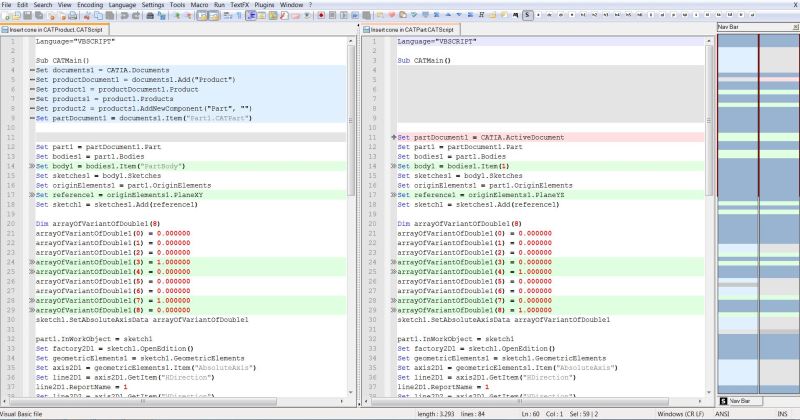

I recorded set of macros for inserting primitives into part.

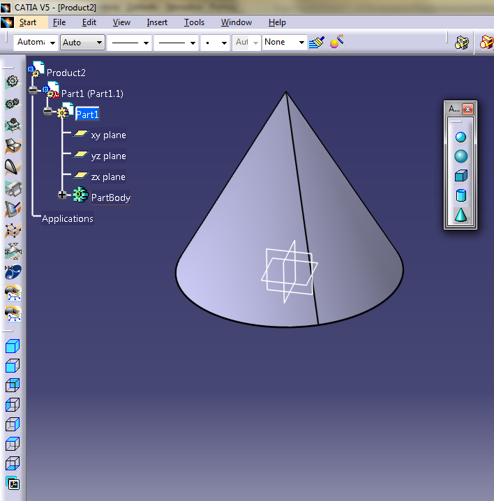

I prepared Toolbar, even icon for cone... It works... but only when i'm inserting primitives to part. When i'm trying insert it to part which is inside Product i have error in line :
Set part1 = partDocument1.Part
(Object doesn't support this property or method).
I can record second set of macros especialy for Product, but I would like to learn how to make this macro more universal.

RE: Insert primitives (cone, sphere, cylinder,...) macro
This is saying that you are in a CATPart as active document. Try record in CATProduct and see the differences.
Regards
Fernando
https://picasaweb.google.com/102257836106335725208 - Romania
https://picasaweb.google.com/103462806772634246699... - EU

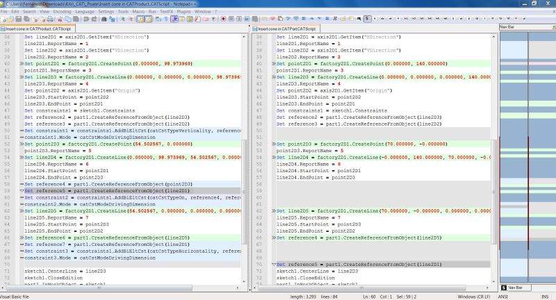

But I don't know how to combine both macros into one. Macro abowe doesn't work on document with one part and vice versa, previous one doesn't work for this kind of product structure (specification tree). On forum I found advice about V5Automation.chm but i'm not programer (yet ;) ) and this is useless on my level. I have tried sign up here https://v5vb.wordpress.com/ three days ago but I have no response. I'm starting adventure with macros, VB, Catscript, VBScript...I this moment I try to understand the difference ;) . Should I write a code with any condition?
I asked my friend for help with it, but he is C++ programer. We tried run this code without success:
And now take a look here
Can you tell what you see? There are some lines with comments in front, when you record something CATIA will put something which it seems to be useless (in other words clean a little bit the code). Please modify the code first and test it. Then think a little bit of conditions: are you running the code with nothing opened in CATIA (like in CATProduct), or there is a specific part or product opened? Think of subroutines who can help you in different cases...you can play also with recording for those cases. Think also at input boxes for you dimensions...and come back with the code, I'm sure there will be peoples which will help you (but read first more in documentation about what you want to do).
Regards
Fernando
Thanks for tip with Compare plugin.
In CATIA_Portable_Script_Center.zip I found Part_2_Product.CATScript . I think it is close to what I need. I have to play it a bit few days.
Best Regards
