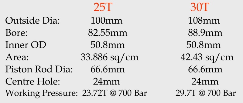

Hello People, i have a question i would like to ask, at this point it may sound stupid, but i don't want to make any mistakes. OK, so, a guy came in to my college to stress my beams (for my final year project), and the stress that he put in was 535, that's what he said, without given the units, and as per usual i forgot to ask him. The gauge that he used i will attach below, so can anyone just confirm how do i convert that into tensile strength of the strand ? or the breaking load ? Thank you very much.

If you knew the gauge pressure at max stress, and the jack ram area you could multiply pressure X area to get an approximate value for force. Looks like the stressing equipment is PJM from Australia.
RE: Prestressing force in strand
I am going to hazard a guess and say that the units to your "535" is 'bar', where 10 bar = 1 MPa. So 535 bar is 53.5 MPa.
PJM Industrial manufacture two sizes of monostrand jacks/rams. One is 25t and the other is 30t capacity, with different effective ram areas, as follows:
If it was the 25t capacity ram that was used, your approx jacking force would be as follows:
Pj= 53.5 MPa * 3,388.6 mm2 = 181 kN
I am going to assume this is NOT 12.7mm 7-wire strand and probably 15.2mm diameter 7-wire strand, with a Ppu of 256 kN, so Pj= 70% Ppu.
Needs verification. Lots of 'ifs'.
