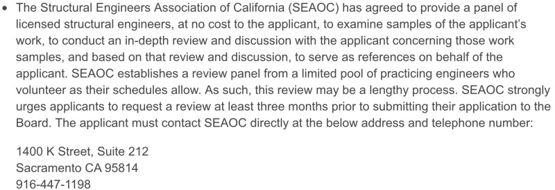

There was recently a post about getting references for your SE application. Someone said that there was a service where you could mail in sample calcs and have some review it, and then they would refer you.
I am not sure if this is true, or even what states it might work in. Does anyone recall that thread; I couldn't find it in my 2 minutes of looking.

appot, the Structural Engineeers Association of California (or whatever SEAOC stands for) will review your qualifications and calculations to provide references if you don't have the required network yourself. It takes something like 6 months.

Following through with Lo's reference to SEAoC, here is what they state at this Link:

the Structural Engineeers Association of California will review your qualifications and calculations to provide references
Seems rather sketchy. Were they also the driving force for the regulation requiring the additional license?
RE: Structural Engineering Licensing Gripes
I'm sure they were (or their predecessors were)
But, they do it for free, so... I'm not sure what sinister motive you're implying.

It appears to me that theyre rather contradictory, pushing more regulation while selectively providing means around that regulation. What this leads to is simple quid pro quo, if you support the guild's policies the guild will stretch its ethics to support you as a qualified engineer for the SE exam. OTOH, if the OP very publicly spoke against the additional exam would he not have a relatively difficult time finding references bc of the legislation the guild helped create?
CWB1 I do not follow how the SEAOC reviewing your work is "providing means around the regulation". The applicant still has to have references willing to PUT THEIR NAME ON THE LINE for them and they are doing it for FREE. Sorry for the caps, but felt I needed to scream that at you
