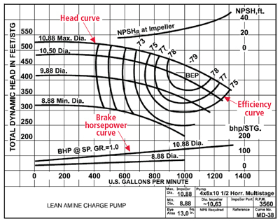

To bring down max power you need to get your duty point on the RH end of the curve, at or beyond Best Efficiency Point (BEP)
E.g. in the curve below, if your duty point on say the top curve was say 600 GPM then there is a large rise in power as flow increases.
If on the other hand you had specified 1000 or 1100GPM as your duty point on the same pump, you would only have up to 1300GPM before you went off the curve, but max power would only increase by ~20% compared to rated power. Like I said - it's all down to the individual pump curve and why you're trying to limit max power. It's all down to good pump selection. Vendors will often try and give you a pump which matches their models, but alternatives are available.
