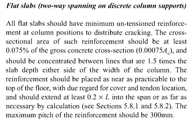

Thanks for your reply. For your information, I have received some info from consultant that refer to British TR43, minimum reinforcement required is 0.075% per section. But, I disagree with the statement. Cause 0.075% is less than the minimum reinforcement 0.13%.

TR43 requires a minimum of 0.075% of normal reinforcement (in addition to any PT) in the top of the slab over column locations to distribute cracking.

TR43 says the minimum top reinforcement for PT slabs is as you stated, and it "includes" any boneded PT in that area, it is not in addition unless the PT is unbonded.
But that is not specific to transfer slabs, it is for any slab. You asked for specific rules for transfer slabs. And that was my answer above.

For your information, 0.075% is adopted for PT flat slab design and not for PT transfer plate design. Most of the PT transfer plate is designed under class 2, and tension is allowed. Furthermore, PT transfer plate is required to tie all the column during transfer force and subject to notional load act as horizontal force to PT transfer plate. Additionally, the presence of steel, either tensioned or untensioned, in the compression zone can be treated in a similar manner to the strain compatibility method described above for steel in tension zone. Based on the requirement, are we still consider the minimum reinforcement to be 0.075%.
