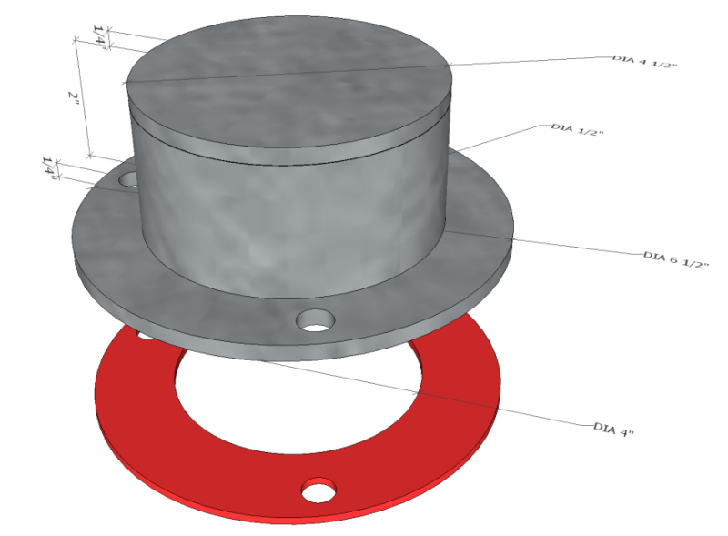

The top-hat end cap was custom fabricated in our shop (very remote from the project site - different country actually - then hot-dipped galvanized before shipping. See 3D image below. Everything on the project was custom - it was an external PT strengthening project to an existing PT slab with extensive corrosion damage. Internal deviators, end plates, some weird skewed angles, etc, everything was custom.
The rubber seal maybe called "custom" too, but in actual fact is was rather crude. Think truck tire inner-tube cut in the field in fit the annular shape of the end plate. This was in a tropical island setting where resources were limited. There were no specifications for the end-cap and seal - it was the early-mid 90's!
In 2009 (15 years after installation) we did an inspection (removal of cap etc) and it was in good visual condition.
In some respects the end-cap above replicates what is used today in multi-strand bridge tendons with grouted/bonded tendons - but the end-caps are now a HDPE or PP polymer with a compression seal material.

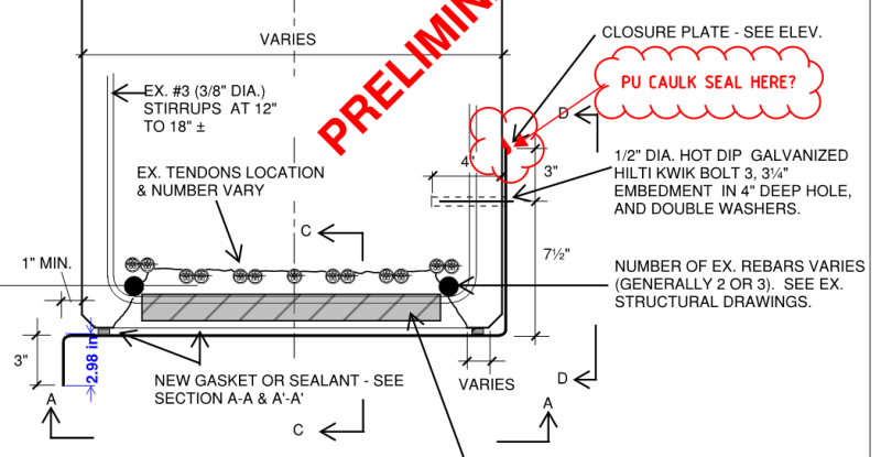

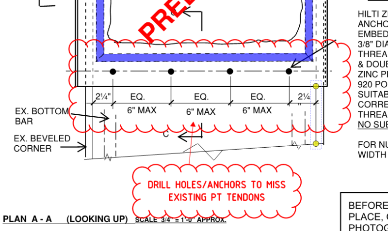

Your two details look good to me. Very detailed and well thought out. Mock-up is a great idea.
1/2" thick neoprene is pretty thick - I thought my 5 mm thick wetsuit was thick - which reminds me: I use a wetsuit (foamed neoprene) glue to repair nicks, cuts and seam failures - so maybe this contact-type cement is the type of glue you need to the corners.
Maybe a few things to consider:
1. Caution the contractor that when drilling for the drop-in anchors NOT to over-drill. Or to drill between the groups of tendons to avoid a potential over-drill situation.
2. Field drill the cover plate holes to match the as-drilled position of the drop-in anchors.
3. Consider a PU caulking at the top (and sides?) of the cover plate as it touches the beam web - in case there are overhead water leaks and water finds it way behind the plate, then get trapped and corrodes the plate.

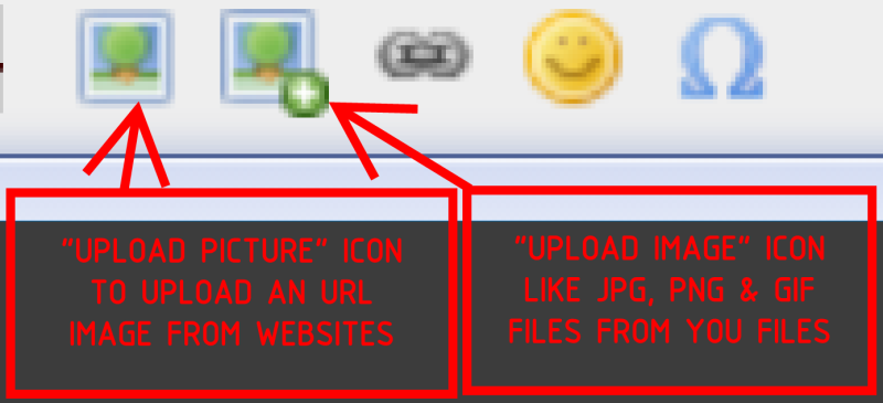

Not sure if this is important to you or not. The two PDF files you uploaded above, when someone hovers over the text it brings up a dialog box and has you name on it. I assume you use Bluebeam or another PDF file maker and it automatically adds such info to its text boxes.
If anonymity if important to you, RED FLAG your two file upload posts and the moderators will delete them. For future files, consider uploading JPEG or PNG copies of you sketches using the UPLOAD PICTURE or UPLOAD IMAGE icon on the Reply To This Thread "menu".

To Ingenuity - thank you for your thoughtful comments. Very much appreciated indeed.
Regarding hitting the tendons, I will add note about over-drilling.
Regarding field drilling the cover plates, I am reluctant to do so as that would leave an ungalvanized edge. Perhaps I could specify a slightly over-sized hole, and double washers.
I will consider adding a PU sealant as you indicate, although I suppose that it should be applied at all edges.
I am thinking now that the idea of a gasket may not be as good as I at first thought. Perhaps my other option (not posted here), of a 1/2" wide wide bead of sealant applied to the plate before it is bolted in place may be simpler and better if it is consistently done right, although it will make any future removal of the plate more difficult.
