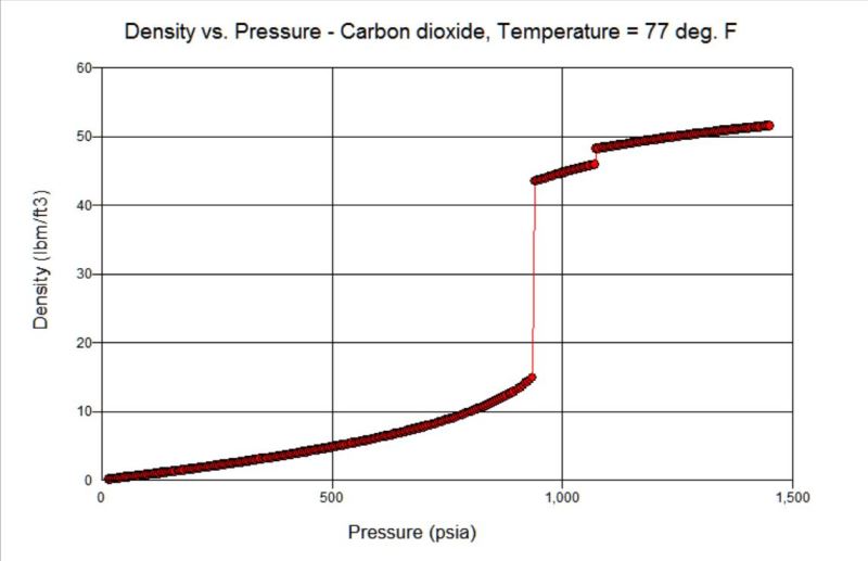

Rather late reply but it wont hurt anybody.
At least from a theoretical point of view, the relation of pressure and density of CO2 at 25C (77F) is shown below.
or
It turns out as shown above that with a 500gr/m3 density (31.21 lb/ft3), CO2 is on a saturated state between liquid and vapor at 64.45 bar (935 psi).
RE: pressure inside the CO2 cylinder
Sorry, that is 500 kg/m3, not gr/m3.

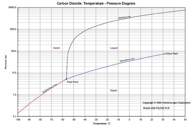

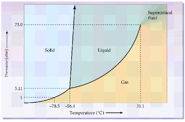

CO2 is weird stuff.
Below the magic critical point of 31.1C, the pressure temperature line should follow the critical path line.
As the temperature changes, the pressure changes along that line when you have liquid and gas. So as you release gas the pressure and temperature falls until heat from outside heats up the liquid to then equalize the pressure.
So quantity is irrelevant so long as there is some liquid in a sealed container.
So for 25C the pressure is around 65 bar.
Beyond 31.1C it all gets a bit weird. (super critical) so can get higher pressures.
