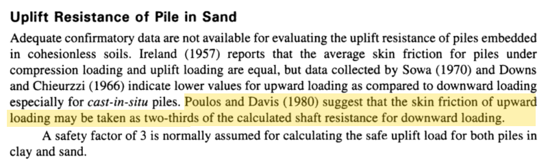

I've seen the value of 2/3 of the friction capacity of a pile in sand (Note: The 2/3 does NOT include point bearing, see below). IMHO, this does not contradict the 25 to 50% range that Ron and Okiryu have offered (percentage of the total pile capacity... including point bearing). A displacement pile, either cast-in-place or driven is going to have significant point bearing capacity in granular soil.

Not sure about piles, but for drilled piers I have been taught that uplift can be calculated by using the skin friction value (in compression) with a 15 percent reduction. No-one has ever been able to sufficiently explain to my why the skin friction value isn't the same in tension vs compression for drilled piers. I could see a reason for the reduction in a driven pile.
RE: Uplift Capacity??
The Poisson effect is one cause for reduced shaft friction in tension compared to compression. This is particularly the case for longer piles. The premise of this is that when you compress a pile, the pile will slightly bulge outwards and further compress the adjacent soil. In contrast, when you pull a pile, the pile will become more slender and the soil would slump towards the pile. Soil is stronger when in compression than in tension, hence the difference in shaft friction for the different loading.
