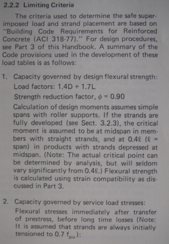

My copy of the 2nd Edition of the PCI Manual states ultimate strength for flexural strength:
I don't have the 3rd Edition, but I would expect it to be similar limiting criteria, so therefore using ultimate strength for flexural capacity, with check on service stresses, and the lower value is the tabulated "safe superimposed service load".

Strength design it is, then. Thanks, Ingenuity. We're not confident of anything but thickness yet. Contractor is aware that scanning will be in order - just trying to make the design reasonable enough that, regardless of what we find when work starts, it won't take too much to make it work. My thought with using the weakest generic plank from the PCI manual is that, hopefully, they wouldn't make anything significantly weaker than that.
