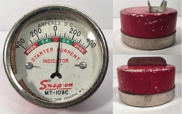

I have seen just such a meter in a Ford 8N tractor. If I recall correctly, out the back of the meter were 2 metal loops about 2x the diameter of the wire that were fairly close together. I can't recall the scale, but I don't think it was much more than charging vs discharging. I never thought much about how it worked, but I can say it still worked with a more modern 3-phase alternator with a diode rectifier. I'd say that Mike is probably giving the answer. The loop probably just held the wire in ~approximately~ the right spot behind the meter so the magnetic field from the wire could directly cause the movement.

Those old Ammeters were cheap and simple. Imagine a galvanometer. Now replace the coil with a small magnet.
Remember the high school experiments where a current flowing in a wire would deflect a magnet suspended by a piece of string.
The 50 era Fords used such a meter. There was a brass clip on the back to position the main charging wire close to and parallel to the internal magnet.
Sort of like putting a compass near a DC wiee.
We used current indicators to check charging circuits and starters that worked on the same principle.
Here's one from E-Bay.Link
The third picture shows the clip on the back for positioning the meter on the starter wire.
I had a similar meter but scaled for 60-0-60 Amps.
I had another one with two scales; 60-0-60 Amps and 600-0-600 Amps. The clip for the 600 amp cable was farther away from the magnet.

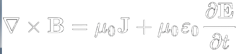

The blurb from Trojan states that their meter works via induction. This has been the source of my confusion--how can you have induction with DC current unless you have an expanding or collapsing magnetic field, i.e. like with an ignition coil?
RE: Non Contact Current Measurement
The MOVING charges (current) in the cable being tested induces a magnetic field.
It's just not the way we usually think of induction, but Ampere-Maxwell's equation has a static current density component:

I'm not sure what link you're referring to, but if it's the type of meter being discussed then they're using the wrong word. Nothing is being induced. The magnetic field around the wire is directly causing the meter to move.

Yes, my father used to have one of those 'two-bit' Ammeters with the V-shaped piece of sheet-metal on the back that you held against a section of wire. I should have kept it but it went missing when we had to break-down and clean-out his shop after he passed-away back in 1989 and my mother decided to sell the house.

Not induction. Simple magnetism. The word induction is probably unfortunate.

It's not "simple" magnetism, by definition, since it requires electromagnetism. The generation of a magnetic field from moving electrical charges described by Ampere, Faraday, and Maxwell is the foundation of all forms of induction. Without this phenomenon, the ammeter wouldn't work.

my father had one for measuring alternator and starter current. This is the first hit I got from google. just place the wire in the channel and measure current
That brings back memories byrdj.
I had one similar but not identical.
Mine was dual range.
The channel on the back was smaller and the range was about 60-0-60 Amps.
As well there was a wider channel similar to the one shown mounted higher on the back of the meter. That was farther away from the internal magnet and had a 600-0-600 Amp scale.
