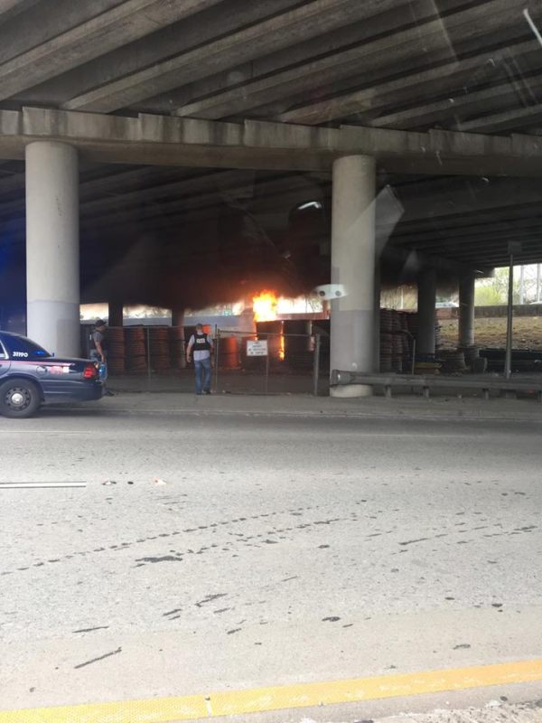

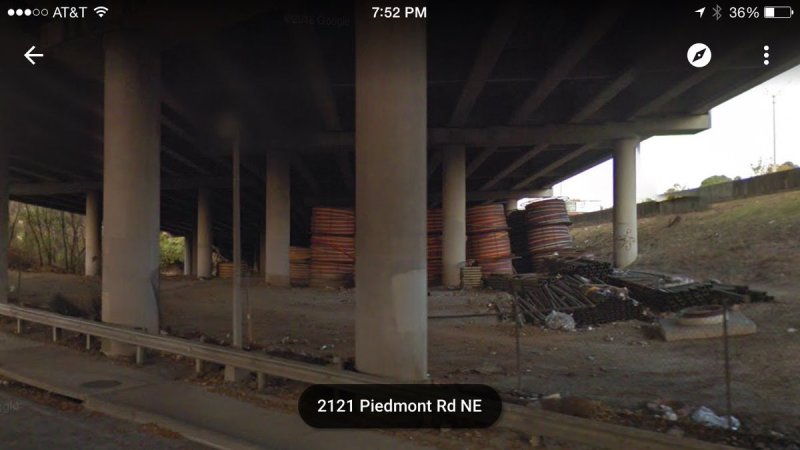

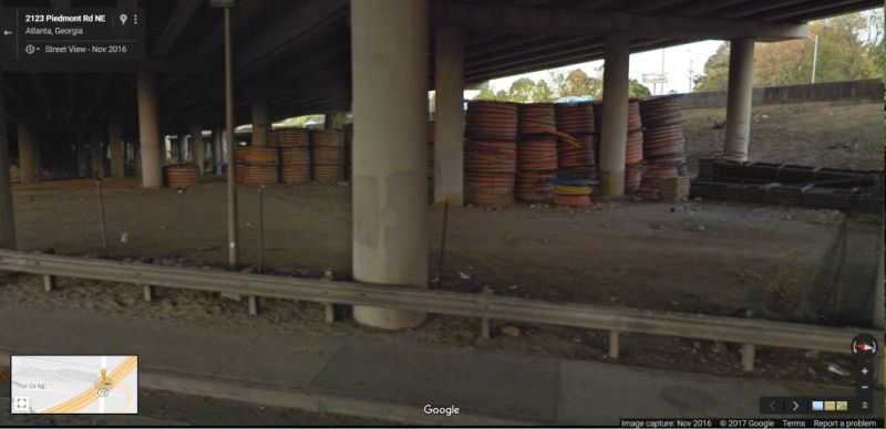

Apparently there was a fenced in compound under the bridge at that point, containing spools of what appears to be Polyethylene gas pipe. A large quantity.
B.E.
RE: Fire in Atlanta
I am pretty confident it was underground fiber-optic conduit on spools (not sure if it was just bare conduit). I also think it was GDOT's yard.

It's so enticing to store stuff under these massive weatherproof concrete umbrellas but what an expensive disaster when any of it burns. Makes me think of good old fire-happy Oakland where for miles the elevated freeway is over shanty-towns, auto-wrecking yards, industrial equipment piles, warehouses, garages, bus storage, abandoned buildings, etc., etc.

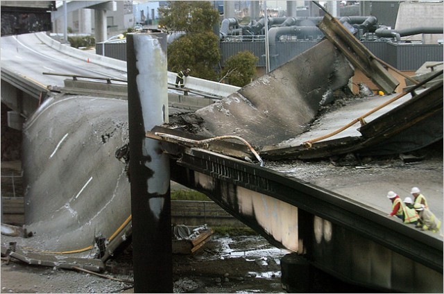

Experts in structural engineering said fires on highways and bridges rarely burn long enough or hot enough to cause a complete collapse — but it has happened. Intense heat can compromise even steel-reinforced concrete, said Lauren Stewart, director of the Structural Engineering and Materials Laboratory at Georgia Tech in Atlanta.
It is SO nice to have a reference to "structural engineering" instead of "An Architect stated...."
McMurry said his department stored coils of plastic conduit, used in fiber optic networks, beneath the span but insisted they were noncombustible.
So if these coils were non-combustible, what the heck fueled such a hot fire?

I wonder if the cables were lubricated for ease of pulling. Wouldn't surprise me if that was what burned and was hot enough to sustain all the other combustibles plastics in the area. I'd also think coils of tube would make great chimneys to direct fire upward.

Can't see much in that area but speculating here: don't forget the wood spools, wood pallets, and who knows what other material; cardboard boxes, tarps, etc. likely in the area.

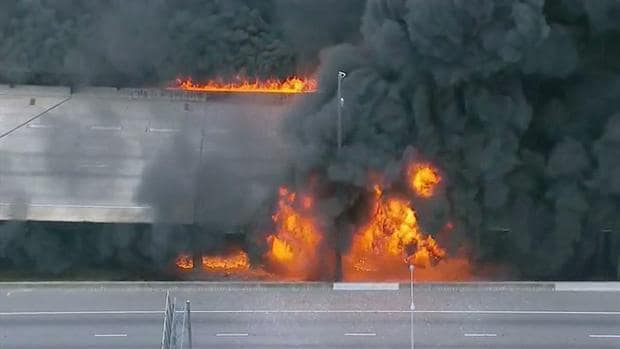

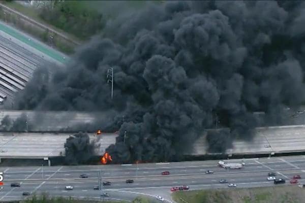

What could have been the source of the heavy black smoke prior to the collapse?
"Where the spirit does not work with the hand, there is no art." - Leonardo da Vinci
RE: Fire in Atlanta
Plastic heated to its melting / decomposition temperature is just like any other hydrocarbon, and when burning in a situation where heat is in ample supply and oxygen is in short supply, it's gonna be a black smoker.
RE: Fire in Atlanta
By the time it got to that stage it would be running and forming pools of burning liquid on the ground. Burning like a World War II naval battle.
