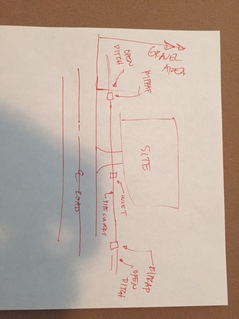

my client site is existing. county widen the road and i believe also increased the road elevation.
county installed a pipe culvert with inlet on the side of the road, in front client site.
but client site is lower than inlet opening so we need to add fill to increase site elevation so it can slope to county inlet.
i want to ask by law what are client rights when county widen road specifically when it comes to flooding client site.
i don't want to just say to client we need to add fill to increase site elevation so it can drain to inlet if this is county responsibility.
RE: can i request the county to lower inlet that was already constructed
see pic attached.. everything is on gravel area except the widen
road which is asphalt..

Did your clients site drain to the existing ditch before or does it drain to another area? Does the new road have a ditch so you have a berm in front of the property now?
yes, site drain to existing open ditch on the side of the original road.
the new widened road, county installed an inlet with pipe culvert, instead of the open ditch it had before (see sketch).
inlet and pipe culvert is fine except site is not draining to inlet because site is lower than inlet opening elevation.
regrading site to flow to inlet is an option but of course this will come at a cost to client.
i'm just curious if telling the county to just lower the inlet opening is an option.
but if this could be a pain and require a lot of paperwork or whatever then we'll just regrade the site

Agree with cvg....if the county caused more water to drain onto your client's site than before, then you likely have a claim.
I would go to the County Engineer and state your case. You have two choices....the county can reset its culvert or they can pay for your fill. Offer those options to the County Engineer.
I'd go further than Ron. When they are done correcting their mistake your site drainage that used to go to the ditch should be restored, possibly by lowering their grade along with the lowered inlet. Possibly even more inlets are needed. You should not have to raise your grade to meet their changes.
