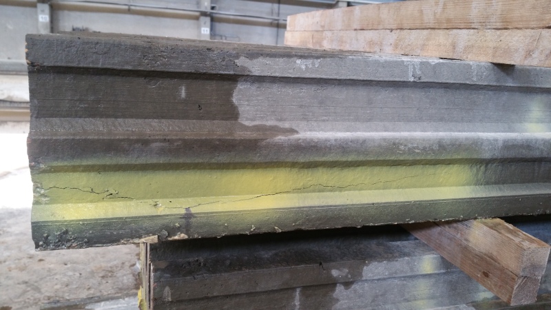

Did the cracks appear immediately after release/transfer of the prestress from the bed to the concrete section?
Quote (amaidj)
i used 5-7dia prestressed wires

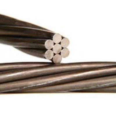

Do you mean 5 each x 7-wire strands or is it 5 each x 7mm dia plain (unstranded) wires?
I would expect the majority of prestress to be in the bottom flange, maybe some prestress in the top - where is your prestress placed in the section?
RE: Prestressed Ground Beams
@Ingenuity, its 7mm dia wire of area 38.5mm2

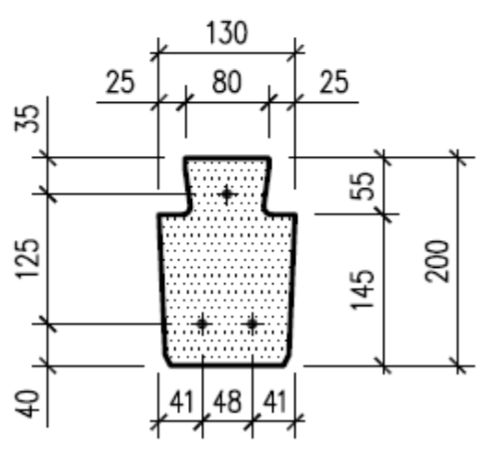

i have 3 wires at 27mm from bottom then one at 50 mm at bottom and them one at 75mm from bottom
these are ground beams use for flooring.
the section depth is 225mm
i think as per my understanding the stress applied is too much for this small secrion which is why it happened at ends and yes it happens at transfer.
@Tehmightyengineer, there is no reinforcement in it other then prestressing wires becuase they are ground beams something like for flooring system and they are so small that no any other reinforcement can be used in there.

Break the bond in some of the prestressing wires at the end to stagger the location where they transfer the prestressing force to the ground beams. Alternatively, provide transverse reinforcement hoops or a wire cage in the ends to resist this bursting stress. Or increase your transfer compressive strength of the concrete.

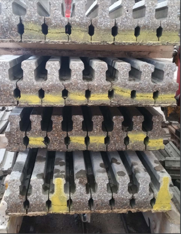

Based upon the 32 beams in the above photo, 21 of them (or 2/3 rds) have horizontal cracking. Not good.
Looks like the product is produced in a long-line bed, using an extrusion process (similar to hollow-core), then cut up into required lengths.
TME's idea of debonding wires or adding transverse rebar may be a major hiccup in your manufacturing productivity - but producing product with such a high rate of cracking is not cost effective either smile

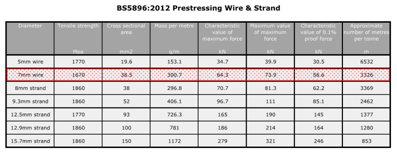

Making a few assumptions and approx calcs:
Assume Peff is 65% of Pu, so for 5 wires your Peff is about 225 kN. Eccentricity of prestress is 41.2mm from bottom (57.7mm from CG).
Assuming an equivalent rectangular section of 225mm deep x 85mm wide your Ig is about 80x106mm4, Ag is about 19,200 mm2
P/Ag is 11.7 MPa!!!
Plug and chug into your classic elastic stress formulae ==> your bottom fiber COMPRESSIVE stress at ends of the member is "theoretically" 28 MPa, and top fiber TENSION stress is more than 9 MPa.
So unless your fci (concrete compressive strength at transfer) is about 40 MPa, you exceed most code-prescribed compression limits of 0.70f'ci (and tensile limits of 0.5√f'ci).

Slight edit to my previous post: I just checked the UTS of 7mm dia prestressing wire and it is only 1670 MPa (not 1800 MPa that I guessed) to BS5896, so if Peff is 225 kN for the 5 wires (45 kN per wire) that is 70% NOT 65% of UTS.

Interesting that the OP is using prestressing wire - it must be a UK thing - as in the US and AU wire is never used today. Small diameter 7-wire strand is used by some precasters in the US and AU.
For example Ultrafloors in AU make similar 'bearers' to the OP using 3 x 9.5mm dia 7-wire strand with a f'c of 65 MPa.

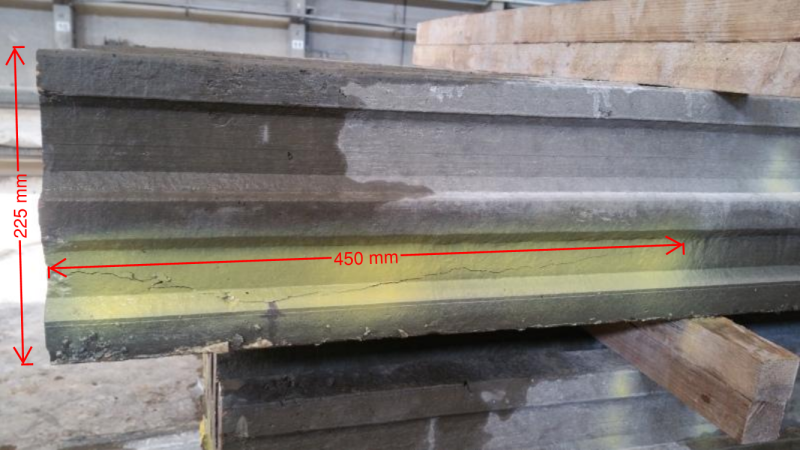

About 100db, so about 700mm for 7mm ø wire.

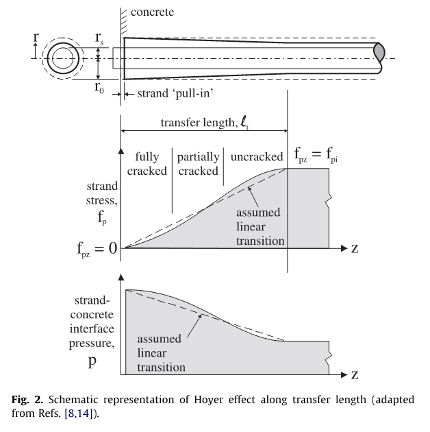

If you look at the Hoyer effect (radial dilation of wire due to Poisson effect) the "cracking length" in the OP's beam is about 450mm or about 2/3rds of the transfer length of 700mm. The location of the crack appears to correspond to the 2nd row of prestressing wire - 50mm from bottom.
