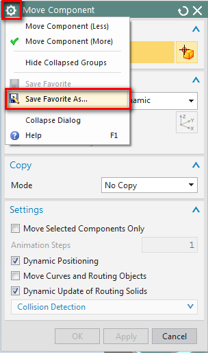

Although the dialog memory should save it to your profile automatically you can aslo save it as a favorite.
Don't think that there is a possibility to save this as a site setting though.
