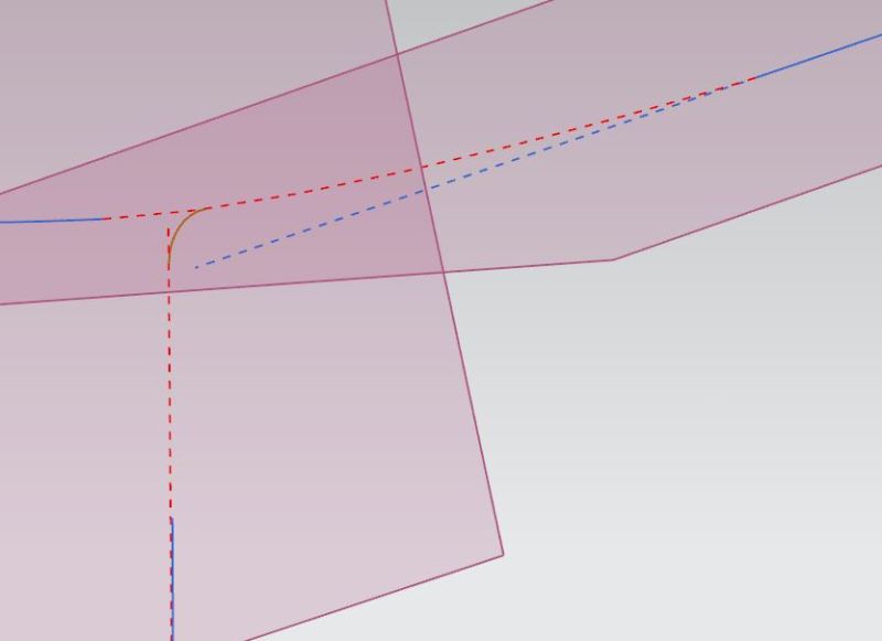

I have two 3D curves in different planes.
Is there an Option which can create a Corner/edge of intersection between the two curves?
I need an Option similar to "Circular blend curve" but should create a Corner instead of a fillet/blended curve.

For example consider straight line, one along X and other along Y axis.
They intersect at origin (0,0) when Extended along one of their sides.
Similarly I have 2 curves in different planes.
I can join those curves using an Option called "Circular blend curve". It does a really good Job in joing 2 curves. But my requirement is to get a Corner not a blend.
As of now I use blend curve Option and create surface, then delete blended edges to get a Corner.

Image for reference
I want to join the red lines in 2 different planes to get a Corner.
I have used Circular blend curve to get Brown line joining them.
@ Vegetagaru
I think Bridge curve works well. I was using the Default section Option to join curves.
But the tiny Problem is that one of the curve Needs to be elongated such that we can select the Point of intersection of the other curve(using object Option). But yeah it works.

I still don't understand this. To me a corner has r=0. The image looks "non zero".
( Autocad used to do "trim corner" by creating a fillet arc with r=0.
In Unigraphics/NX creating a circle with r=0 is/was: "what? the radius can be anything but zero, zero would make the object disappear".)

Use bridge curve as stated above. Set the parameters you want, either arc percent arc distance for when the curve will start, then keep the tangency rules at "1" for a even blend curve.
