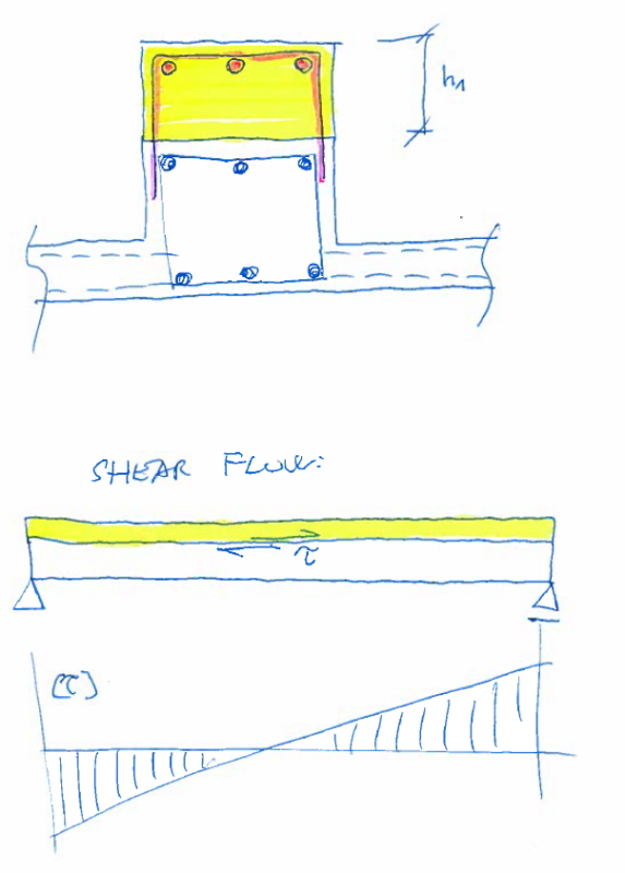

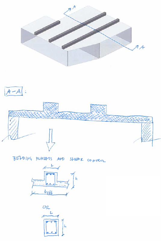

Now im dealing with an existing structure - RC beams + slab at the bottom.
What do you guys usually do - do you control existing beam for bending moments and shear forces:
1) on a beam modeled as rectangular section
2) on a beam + slab (beff) - reversed "T beam"
I suspect that option 1 is more conservative?
Lets say that bending and/or shear control doesnt go through. Can I solve this problem by adding another layer of concrete on top (lets say h1 = 15 cm height). Im thinking about drilling holes in existing beam + epoxy and new stirrups + rebars. I would also control shear flow between existing and new/added concrete part and consider this when determining spacing between stirrups.
RE: control of existing RC beams
I wouldn't bother with T-beam action. There's really little benefit when the slab is in tension unless you have rebar congestion issues in the beam. As for the extra layer, see this thread for essentially the same problem: Link

one more question...
new stirrups are loaded with horizontal shear forces (because of the shear flow between existing beam and a new concrete part on top of it) + with vertical shear forces.
does that mean I have to consider interaction: shear + tension when designing stirrups and spacing between them?
You're very welcome.
Quote (OP)
but I thought that the slab at the bottom of the beam provides benefit as far as shear strenght goes?
Not much. We normally consider the web of flanged things as resisting all of the shear.
I don't believe so. The forces are complementary rather than additive in this situation.

Look at ACI 318-11, section 11.6.7.
"Net tension across shear plane shall be resisted by additional reinforcement..."
So if your original section (and stirrups) have an adequate ΦVn, equal to ΦVc + ΦVs, then your added beam depth above doesn't need to provide additional vertical shear capacity and your shear friction reinforcement crossing the plane between the two sections can be designed for only the horizontal shear.
However, if your original section ΦVn is not adequate and you need additional vertical shear capacity as well, you would then need to include new shear reinforcement for BOTH the horizontal shear and the additional ΦVs you need. These would be additive.

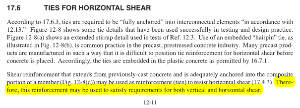

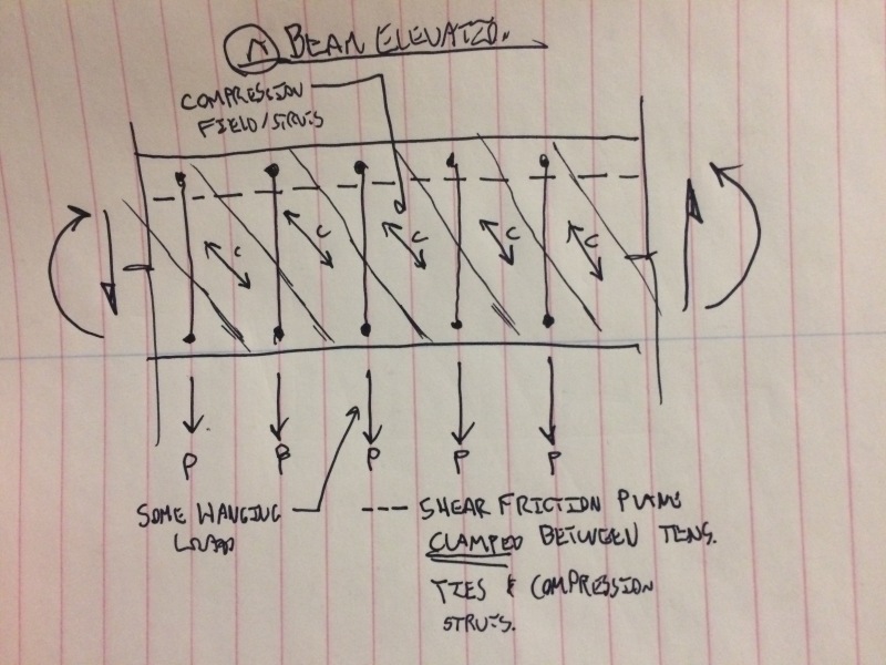

Quote (OP)
Quote (KootK)
In support of my previous statement, I submit the following:
1) The sketch below showing my understanding of the mechanics of the situation. As I see it, the truss action associated with vertical shear reinforcing creates a complementary compression field over plane on which shear friction capacity is desired. This is why I feel that shear stirrups can pull double duty as both vertical shear reinforcing and shear friction reinforcing. This is similar to what we do with the vertical bars in shear walls at the slab joints.
2) The clip below taken from PCA Notes 318-11 which appears to be in agreement with my interpretation. Calculation example 12.6 of the same document proceeds along similar lines.
