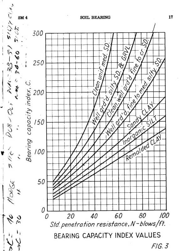

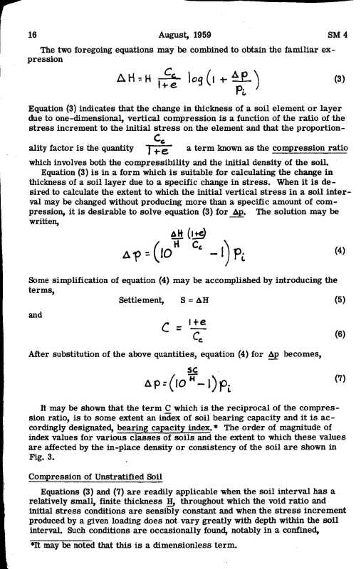

OKiryu: In reply to your comment, placing enough safety factor on a soil rupture failure might be the practice of some, but not me. The question on determining the settlement for granular soils may set some back in doing that computation, but in my experience settlement allowable governs the recommendation for soil bearing for most foundations on most soil types. Look up the ASCE Journal of Soil Mechanics and Foundations, paper number 2135 of SM 4 group by B.K. Hough labeled "Compressibility as the Basis for Soil Bering Value". That was in August 1959 and it had more discussions on the subject that any ASCE paper before it. Of course Peck and others got into the argument. Hough was my undergrad and grad soils engineering professor at Cornell and later I worked a few years for him in his private Prentice. In later work places and in private practice I used his methods and have passed them on to those I have worked with, with success, no failures. Hough's new term "Bearing Capacity Index" has worked out great for me. Where shear strength values are known, yes a safety factor is applied, but only RARELY governs the design recommendations. I've given this same "sermon" before on these rooms so a search on this WEB site may bring up more details for those interested. The second edition of Hough's text (Basic Soil Engineering)is sufficient to get one going on how to use it on a spreadsheet. Some improvement modifications of the original paper methods are needed then.

OG, yes agree. I reread my previous post and noted that I made a mistake. I meant to say that settlement NORMALLY governs the design. Also, I have the Hough's charts you mentioned (I downloaded them from your old posts), but I was wondering if you can share that paper with us. It will be interesting to see the discussions. Thanks!
RE: 3" OD split spoon sampler
OG back with a little info. The original paper had some approximations on using things not useful now, but here are three jpg files. The first is one page of the paper showing the reasoning for the new factor, bearing capacity index. Third a page showing relating that factor to blow count (the old rope on the cat head result). Secnd a copy of a page from the first edition of Hough text and my notes where some of my test data fits and the value "C" for the various lines plotted near the right border. Note that some f my plots have less slope than Hough's figure had.

OG again. For using the Hough method in a spreadsheet you do the computations for small layers at a time, such as one foot thick each and add the results. Then, if you wish to get fancy and design footing foundations for equal settlement, run a whole batch of computations varying column loads and footing size, plotting that with data points labeled for settlement computed. Draw lines of equal settlement. Then give to structural engineer to pick his footing size for each column load, hopefully coming close to them actually setting equally.
