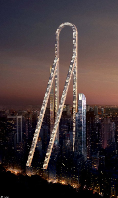

That is some moment frame

this one.... breath-taking, and very clever. obviously a weak and strong axis. a 4 legged thingy, with strong and weak axis the same, would be interesting.
calculation-wise, i'm sticking with my 1-4 story thingies

111 West 57th Street (next tallest beside it) has a slenderness of 1:23.
This proposal surely does past 1:30...
RE: That is some moment frame
Initially, I thought that the interconnection between towers would yield no benefit in the direction perpendicular to the "moment frame". And, from the perspective of static overturning resistance, I think that's true. However, these super talls tend to be governed by occupant comfort under wind. Any chance that the interconnection would help in that regard? Wind confusion? Torsional stiffness and damping? Reduced probability of maximum load effect on both towers simultaneously?
I've only done twenty or thirty buildings this tall so I'm really no expert.
