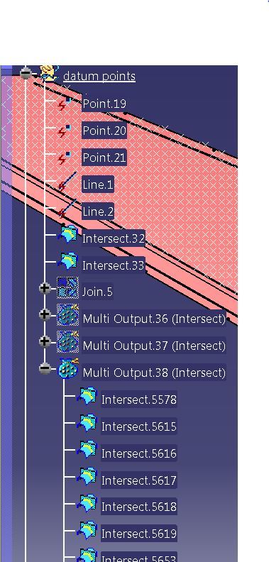

I try use the script but now I have a new problem.
I create parallel planes in x, y directions and intersect with my surface. How do I can create points in the intersections lines?
I run the scrip and I recognize only 3 points.
In the next image show a little bit of my catpart with the projection lines.
Best regards
RE: Projection points onto surface
You need to have points at all your intersections.
Intersect your vertical lines with your horizontal lines or planes.
I use this command Shape -> Generative Shape Design -> Intersection and the result appear in the next image.
I run the script but he recognize only Point.19, Point.20, Point.21.
In Multi Output.38(Intersect) we see the intersections lines.
It is necessary convert or what else this intersections in points? If I move the mouse and add manually one point the script recognise that point, but not the others.

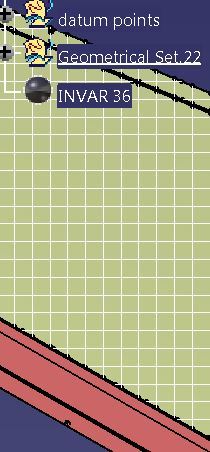

Excel Macro looks for points versus intersects, even though your intersect results are points.
you can do a few things.
Turn your history off (create datum icon) and re-intersect your curves.
OR create a new geometric set, grab your multi outputs, rmb copy, paste special as result to your new geometric set.
OR same as above but paste special as result to a new empty file.
OR grab all your intersects , rmb > selected objects > isolate.
The excel macro grabs all the points from the geometric set selected, after you initiate the macro.

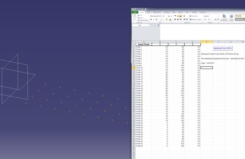

Hello Rickyt
I follow your suggestion but I don't have success.
I found one tool bar (Time saving Toolbar) and I use this option "Convert Isolated Points to Coordinates".
With this option I convert the points and lately i export to Excel.
Where I can find one macro only to convert the points to coordinates?
This is the only one that I have used.
Once points are in excel, you can then format cells to a number and choose how many decimal places.
Then save it as a csv file.
Afternoon itsmyjob afternoon
I have successfully successfully exported the points. However I need help again.
I would like to automate the mu process.
I created a macro to create me parallel plans with the following names:
"Plans XZ" and Plans YZ.
Is it possible to use the "Intersection" command directly in my code?
I have already recorded a macro to do this but it only works on this model.

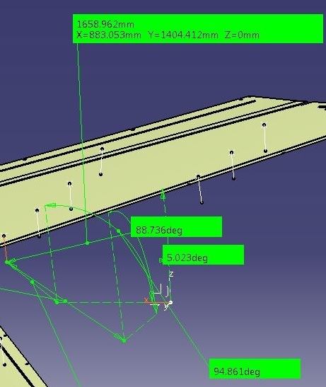

My other question is that I need to create normal lines to the surface from the previously created points and check the angle value in the 3 directions.
Below I send an image of what I intend.
If you can help me, I thank you.
