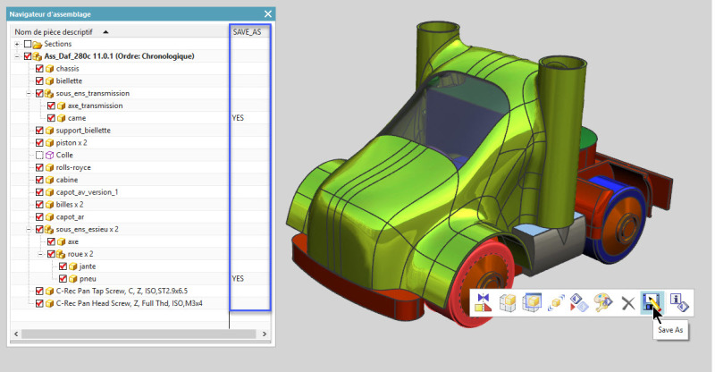

I have a journal that save as all part with a given suffix in NX11. (I can't use clone because some parts are family members !!!)
Now, I would like to perform a specific save as for a list of component and maye the list could be set in Excel with export ANT to spreadsheet
and for all renamed part all upper levels must be renamed automatically like the following example
Is it easy to do the job ? and does anybody can help me ?
Thanks in advance

Pending an answer, I continued and I found the following idea to avoid using spreadsheet by using an attribut save_as.
I also added a button when a component is selected and I need a journal to save as the selected component with a specific suffix which is another attribut
Thanks in advance for your help

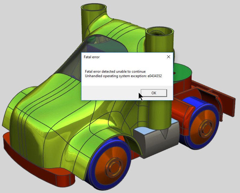

RE: Selective save as in vb
Thanks a lot, but I have the following message in NX11.0.1
Regards
Didier Psaltopoulos
http://www.psi-cad.fr
Just now I tried it in my nx8.5(the native version)
And it worked.
I need to know what this error mean.

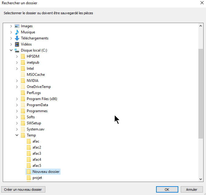

Thanks a lot.
I modified the journal for a more simple directory selection and I tried it in NX10
But the result is in UGII_BASE_DIR and not in my selected folder
